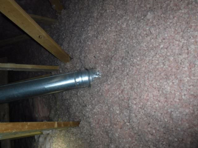

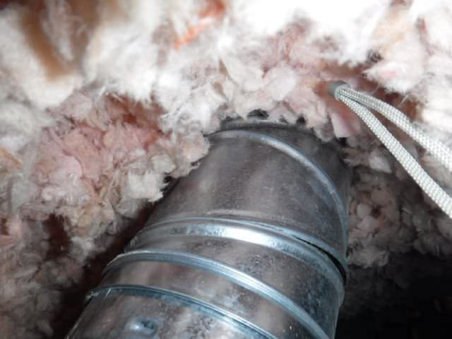

Mike Lamb Posted March 6, 2017 Report Posted March 6, 2017 I have never put B-vent together. Ignoring the insulation issue, is this small gap at the connection of any consequence? Click to Enlarge 50.9 KB Click to Enlarge 46.26 KB
Jim Katen Posted March 6, 2017 Report Posted March 6, 2017 The outer wall is broken, the inner liner might be as well. Someone should replace it.
mjr6550 Posted March 6, 2017 Report Posted March 6, 2017 I would be concerned that if the elbow was installed out of alignment such that it separated at the outer joint, then the inner joints could also be damaged.
Jon Hodgkins Posted March 21, 2017 Report Posted March 21, 2017 This is not uncommon during installation, but definitely should not have been left like this. Maybe someone bumped into it. Remove the elbow, pop the metal bead back in it's groove so that the elbow swivels freely, and reinstall. If the bead does not stay in it's groove, than I would get a new elbow.
