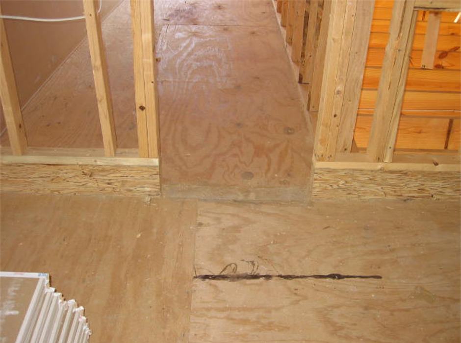

hausdok Posted January 11, 2006 Report Share Posted January 11, 2006 Click To EnlargeOh! It's a beam?.....Oops. Contributed by Donald Lawson V.I.P. Home Inspections Houston, TX Link to comment Share on other sites More sharing options...

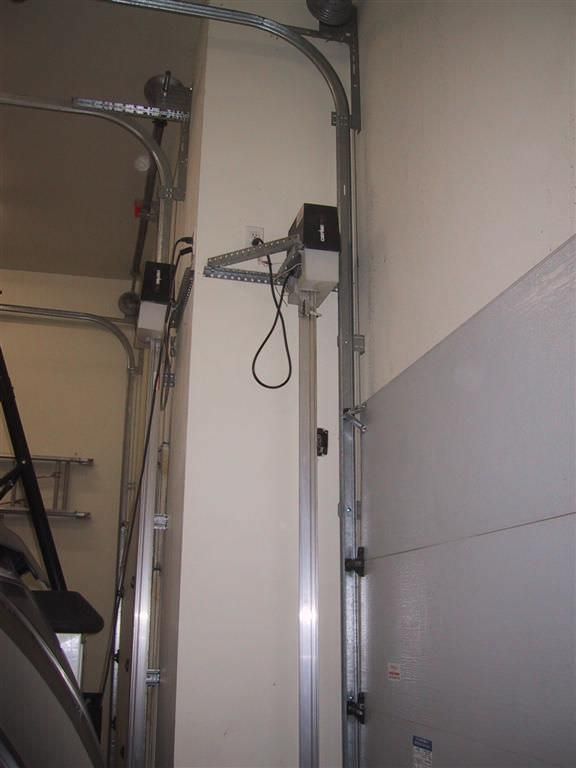

Terence McCann Posted January 13, 2006 Report Share Posted January 13, 2006 Might that be an authorized addon from the manufacture??? If not the installer is resourceful and a part time engineer to boot. Looks like the safeties are wired in, were they working? I gotta say, I'm pretty damn impressed. Link to comment Share on other sites More sharing options...
Jim Katen Posted January 13, 2006 Report Share Posted January 13, 2006 Here's another approach. What would you say about this one? - Jim Katen, Oregon Download Attachment: GDO_Vertical.JPG 40.8 KB Link to comment Share on other sites More sharing options...
hausdok Posted January 13, 2006 Author Report Share Posted January 13, 2006 I can imagine some kid getting his hand caught in that. OT - OF!!! M. Link to comment Share on other sites More sharing options...
Darren Posted January 13, 2006 Report Share Posted January 13, 2006 Jim, When those doors were operated, did they bind at all or did they go smooth? I can see the doors going up & down a bit skewed... Terry, The eyes & pressure were operating OK. My concern would be additional 'play' in the chain as it wraps around the corner. I did search LiftMaster web site, could find no type of modification devices as pictured. Darren Link to comment Share on other sites More sharing options...
hausdok Posted January 13, 2006 Author Report Share Posted January 13, 2006 It looks jury-rigged to me. If it were a manufacturer's accessory you wouldn't see the welding burns on the steel. OT - OF!!! M. Link to comment Share on other sites More sharing options...

chrisprickett Posted March 3, 2006 Report Share Posted March 3, 2006 I vote Lawson's notched microlam! Link to comment Share on other sites More sharing options...
hausdok Posted March 5, 2006 Author Report Share Posted March 5, 2006 Hi Chris, Yeah, that is a good one. Anyone got a suitable caption. Anything I have to say about it probably isn't too politically correct. OT - OF!!! M. Link to comment Share on other sites More sharing options...
Brian G Posted March 5, 2006 Report Share Posted March 5, 2006 "Have you seen one of those new "walk-through" beams yet?" [:-dopey] "Well I just knew they wouldn't want to keep stepping over the dang thing, so..." [:-dunce] No-no, you don't understand...we ordered it that way." [^] Brian G. A Few Options Link to comment Share on other sites More sharing options...
BADAIR Posted June 15, 2006 Report Share Posted June 15, 2006 Press release Thursday, June 15, 2006 The North American Wood Department (NAWD) announces "Inviso-beam" Acts like a glulam without all of the interferences. Link to comment Share on other sites More sharing options...
