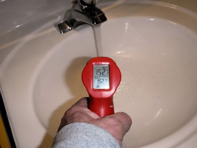

Mike Lamb Posted February 27, 2017 Report Posted February 27, 2017 This is the hottest I have ever measured tap water. 152 F. Click to Enlarge 28.08 KB Click to Enlarge 56.71 KB

Jim Katen Posted February 28, 2017 Report Posted February 28, 2017 This is the hottest I have ever measured tap water. 152 F. Click to Enlarge 28.08 KB Click to Enlarge 56.71 KB That's a really inaccurate way to measure water temperature.

Jim Baird Posted February 28, 2017 Report Posted February 28, 2017 This is the hottest I have ever measured tap water. 152 F. Click to Enlarge 28.08 KB Click to Enlarge 56.71 KB That's a really inaccurate way to measure water temperature. And a better way is...?
Marc Posted February 28, 2017 Report Posted February 28, 2017 This is the hottest I have ever measured tap water. 152 F. Click to Enlarge 28.08 KB Click to Enlarge 56.71 KB That's a really inaccurate way to measure water temperature. And a better way is...? Thermocouple. You can buy them as accessories to plug into your multimeter. I ditched my IR thermometer several years ago in favor of a thermocouple accessory for that reason. Marc
Jerry Simon Posted February 28, 2017 Report Posted February 28, 2017 And a better way is...? A meat thermometer. Same thing I use to check AC temp split.
Tom Raymond Posted February 28, 2017 Report Posted February 28, 2017 This is the hottest I have ever measured tap water. 152 F. Click to Enlarge 28.08 KB Click to Enlarge 56.71 KB That's a really inaccurate way to measure water temperature. It is, but used this way will tend to read low.

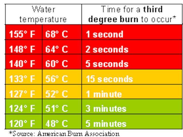

Mike Lamb Posted February 28, 2017 Author Report Posted February 28, 2017 I test water temp with my hand. If I can't hold it under the tap for more than 1 or 2 seconds it's too hot. The laser thermometer is mostly eye candy like my cheap thermal imaging camera. It shows a picture of what I already know. The accurate temp is not important to me.
Jerry Simon Posted February 28, 2017 Report Posted February 28, 2017 I test water temp with my hand. If I can't hold it under the tap for more than 1 or 2 seconds it's too hot. Your chart shows a third degree burn can occur in 1-2 seconds if water temps are between 148 and 155 degrees. I'd never risk testing water temps that way.
Mike Lamb Posted February 28, 2017 Author Report Posted February 28, 2017 I test water temp with my hand. If I can't hold it under the tap for more than 1 or 2 seconds it's too hot. Your chart shows a third degree burn can occur in 1-2 seconds if water temps are between 148 and 155 degrees. I'd never risk testing water temps that way. If I were you I wouldn't risk it either. The elderly and young children have a much slower reaction time.
Jerry Simon Posted February 28, 2017 Report Posted February 28, 2017 I test water temp with my hand. If I can't hold it under the tap for more than 1 or 2 seconds it's too hot. Your chart shows a third degree burn can occur in 1-2 seconds if water temps are between 148 and 155 degrees. I'd never risk testing water temps that way. If I were you I wouldn't risk it either. The elderly and young children have a much slower reaction time. Stupid is as stupid does. . .

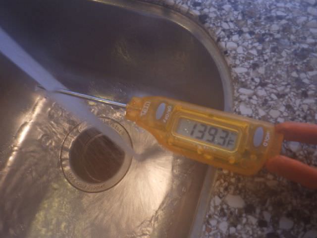

Jim Katen Posted February 28, 2017 Report Posted February 28, 2017 And a better way is...? An HVAC thermometer. Attach it to a small spring clamp. Let the water run while you do other stuff and glance at it every now and then. Not only will this allow you to see the peak temperature, but you will also see the temperature curve - making is really easy to spot broken dip tubes. Click to Enlarge 36.12 KB
Jim Katen Posted February 28, 2017 Report Posted February 28, 2017 Example. Download Attachment: Test.pdf 221.9 KB
Marc Posted February 28, 2017 Report Posted February 28, 2017 Example. Download Attachment: Test.pdf 221.9?KB That's really cool. Marc

Rob Amaral Posted March 1, 2017 Report Posted March 1, 2017 I use a typical "Taylor" brand HVAC thermometer in a cup... run the water a while... etc.. serviceable...
