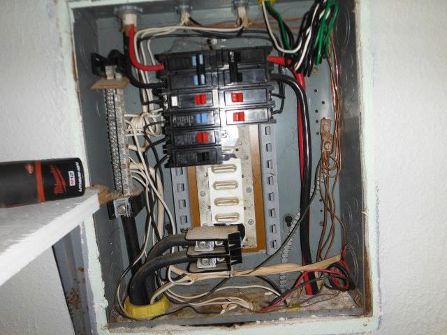

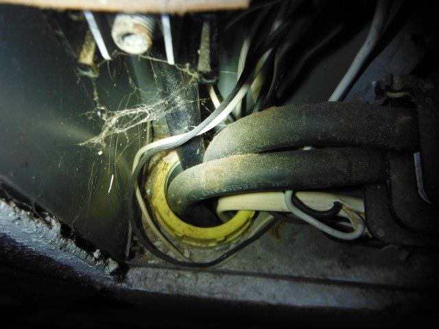

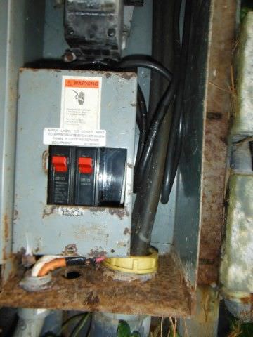

200 amp main panel outside on post has 3 wire feeder to garage 200 amp sub panel.
Should there be an equip ground there too?

Where's the main disconnect? Are those two breakers in the photo fed by a tap or by a branch circuit coming from the breaker panel situated elsewhere?
The neutral can be bonded to earth anywhere between main disconnect and breaker panel. Grounding conductor starts at that bond and runs downstream from there.

Posted
They separate at the garage. So, cant clear a ground fault that way?

Right. At least I think so. 250.32 B (exception 3) says that installation shouldn't have any GFCI devices in the garage.

If they're separate, yes, the equipment grounding conductors won't do their job very well.

Actually, that's talking about ground fault protection of equipment (GFPE), which is almost certainly not going to be present in this garage. It's fine to have GFCIs in there.
Ground faults aren't going to be cleared because there's no low impedance path back to the neutral.
Posted
So, having the post up the driveway for the main breaker doesn't make the house like a separate building that needs its own 6 or less breaker deal?
Sorry. You're correct. It needs 6 or fewer disconnects.
