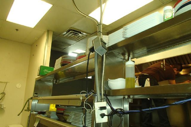

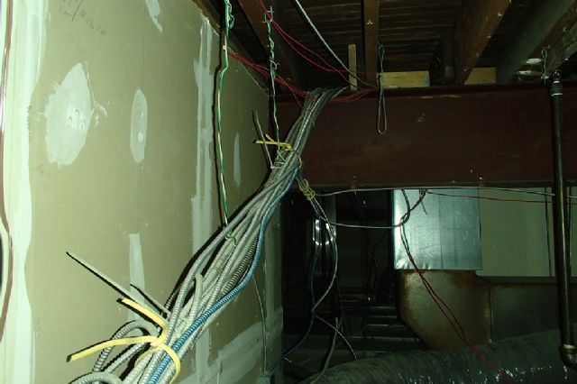

mjr6550 Posted February 2, 2017 Report Share Posted February 2, 2017 Bundling/attachment Click to Enlarge 42.86 KB Click to Enlarge 39.42 KB Improper wiring? Click to Enlarge 46.54 KB Link to comment Share on other sites More sharing options...
Jim Katen Posted February 2, 2017 Report Share Posted February 2, 2017 Absolutely. Link to comment Share on other sites More sharing options...
Marc Posted February 2, 2017 Report Share Posted February 2, 2017 Lord, yes. Marc Link to comment Share on other sites More sharing options...
Chad Fabry Posted February 2, 2017 Report Share Posted February 2, 2017 Yeah...it's a mess. Link to comment Share on other sites More sharing options...
Jim Baird Posted February 2, 2017 Report Share Posted February 2, 2017 ...with the AC, no. With the box fastening, yes. As an AHJ I had a discussion of bundling with an electrician whose wire puller put a bundle of romex into a pvc sleeve to penetrate a ceiling frame. His argument about typical residential loads won my approval. Link to comment Share on other sites More sharing options...
John Kogel Posted February 2, 2017 Report Share Posted February 2, 2017 Bundling becomes a concern if it istretches 12 feet or more, and I have never come across more than a couple of feet in residential. But those pictures show long spans with no clamps, and missing securement of boxes, and bundling, too. Yep, it needs repair and that means support and clamps every 4 feet. Link to comment Share on other sites More sharing options...
Jim Port Posted February 3, 2017 Report Share Posted February 3, 2017 Are you thinking that this bundling is creating a derating issue? If so you are wrong. Link to comment Share on other sites More sharing options...
Jim Katen Posted February 3, 2017 Report Share Posted February 3, 2017 ...with the AC, no. With the box fastening, yes. As an AHJ I had a discussion of bundling with an electrician whose wire puller put a bundle of romex into a pvc sleeve to penetrate a ceiling frame. His argument about typical residential loads won my approval. The bundling (what there is of it), is the least of the problem. Link to comment Share on other sites More sharing options...
