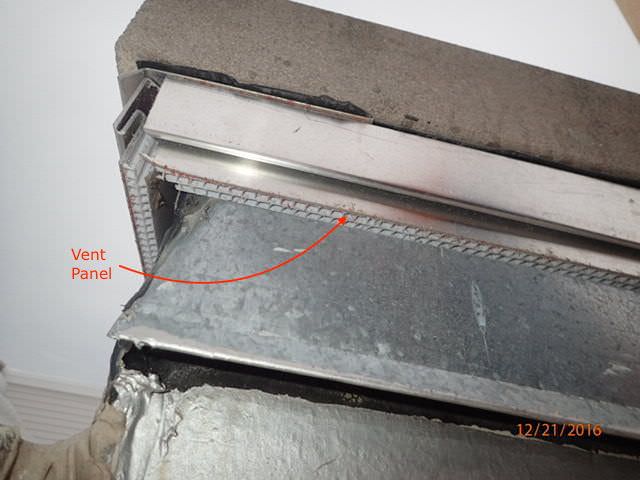

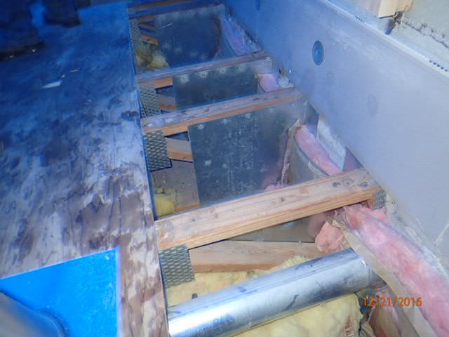

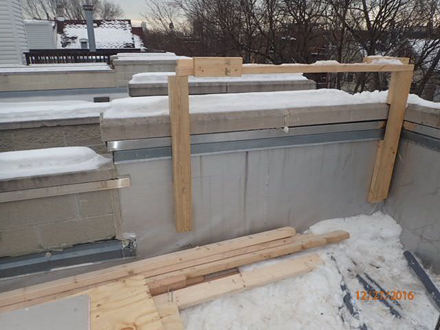

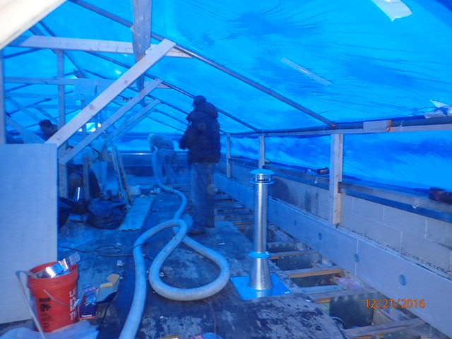

kurt Posted December 22, 2016 Report Share Posted December 22, 2016 Shrink Wrap Tent Click to Enlarge 60.45 KB Cozy inside Click to Enlarge 50.02 KB Truss ends rotten, bracketing to wall Click to Enlarge 45.77 KB Click to Enlarge 51.81 KB Some were so bad, we gusseted it back with plywood. Click to Enlarge 42.21 KB Vented coping close up. Click to Enlarge 48.31 KB Can't hardly tell it's there. Full perimeter ventilation, works like a charm. Click to Enlarge 56.86 KB Link to comment Share on other sites More sharing options...
Marc Posted December 22, 2016 Report Share Posted December 22, 2016 The gussets and fasteners were engineered? Marc Link to comment Share on other sites More sharing options...

kurt Posted December 22, 2016 Author Report Share Posted December 22, 2016 Thanx. You're welcome to check out a job. We think the neighbor a couple doors down is going to go for it. If you want to see it, let me know. Kelly designed everything. When our engineer looked it over, he determined we'd over built by several gauges on the sheet metal. The huge majority of architects and engineers all insisted we had to replace the truss. God Bless the engineers, but I wonder what part of their education extracted all creative problem solving ability. We have to restrain ourselves from reminding them they're the folks that designed this stuff in the first place. The vent stuff is 100% Kelly. Link to comment Share on other sites More sharing options...

kurt Posted December 22, 2016 Author Report Share Posted December 22, 2016 Kelly designed it and "engineered" it. It's something we'd been talking about for years...sheet metal brackets and plywood instead of gutting the house. The engineer just ran the numbers through his license so we had something to stand on. You know I was just ****ing with you about the visions, don'tcha? It was an honest question. This is, after all, Chicago, where anything can happen and it does. Link to comment Share on other sites More sharing options...

kurt Posted December 23, 2016 Author Report Share Posted December 23, 2016 He ran calculations; he didn't rubber stamp it. He told us to make it a lot less strong than we were going to initially. Link to comment Share on other sites More sharing options...
RJ Posted December 23, 2016 Report Share Posted December 23, 2016 Kurt, Thanks for posting the pictures of the project. That tent enabled us to hunker down even in the worst weather and keep working; or at least leave the entire roof exposed at the end of the day without worry. So now, we have the whole system, not part, designed out: Masonry and roof venting, tent- allows unto take a look at the entire roof without the pressure of closing every night- (boat shrink wrap ROCKS!) Reinforcing the structure; adjust the insulation and mechanicals as needed. As always, I appreciate your invaluable advice and involvement on these projects. Marc, the gussets and brackets were engineered. The engineer checked the math on my design and fastener selection Btw, engineers are well meaning: its too bad you can't jamb 25 yrs of experience (i.e. dirt, grit, cut hands, hot sun, cold weather, heavy lifting, etc, etc ) into a 2 year course.... -Kelly Link to comment Share on other sites More sharing options...
