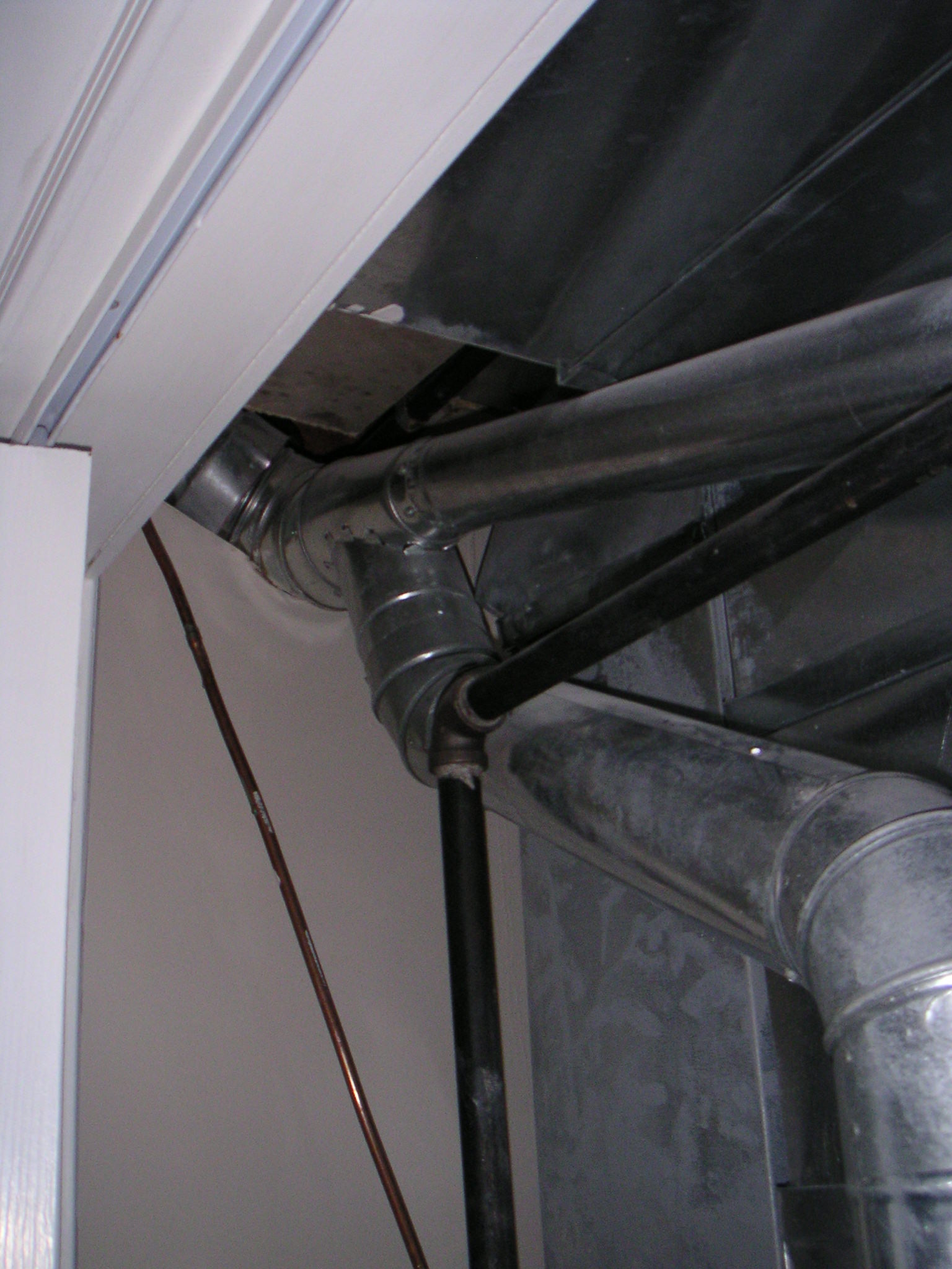

pete Posted January 26, 2004 Report Share Posted January 26, 2004 I just finished an inspection on new construction and this setup has me running in circles. The wh is the smaller pipe and the mid efficient furnace is the bigger. Is this setup ok? I know the smaller appliance should enter above, but how about behind? The wh flue is on a higher plane. Thanks, Pete Normally we have 2 days to send out reports but buyer is paying extra for fast report. So I am under the gun. Download Attachment: 01-26-04 024.jpg 1119.85 KB Link to comment Share on other sites More sharing options...
a46geo Posted January 26, 2004 Report Share Posted January 26, 2004 Pete, It wouldn't pass in Michigan. Your concerns are valid. Also the junction is too close to the ell compounding the concern. The power vented furnace could indeed have the exhaust gasses pushed back down the WH vent with this configuration. Having said that, did it pass the local inspector's keen eye? Is there any clearance between the smoke pipe and what looks like a gas line? George Link to comment Share on other sites More sharing options...

chrisprickett Posted January 27, 2004 Report Share Posted January 27, 2004 Pete, Along with what George said, it doesn't look as though the flue pipe has enough (if any) support. Link to comment Share on other sites More sharing options...
