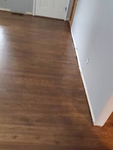

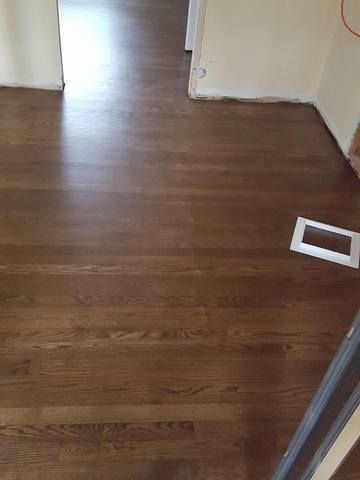

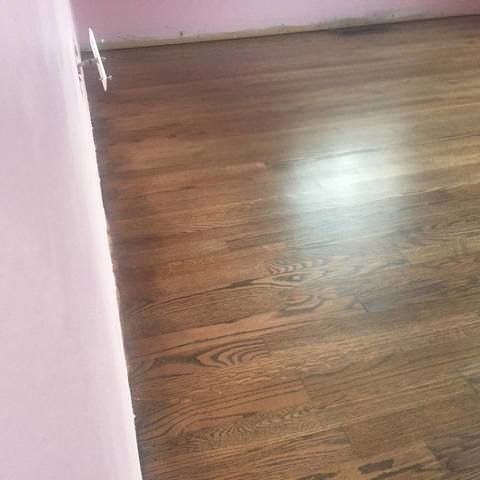

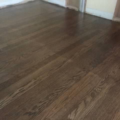

I had my red oak floors refinished and stained to a dark Jacobean color with Dura- Seal stain and three coats of water based poly. The result did not turn out so great. I have a bunch of blotches in color and lines in the stain from what I believe to be the sanding.
Some of the pictures make it look worse than it actually is. I know it's really hard to tell colors and all from pictures, but what do you guys think went wrong and any chance of fixing it?
I'm hesitant to let the contractor touch the floors again.

Right, I think the stain was slapped on too soon. He should have gone over the uneven spots where the drum sander dug in.

Thanks for the comments guys. I'm disappointed to say the least. I like to do everything I can myself on my own home, but have no experience with refinishing floors so left this one to the pros. I paid a floor guy good money to do this. He was a referral from another contractor I know well. I did inspect the floors when the stain was down and did not see these lines and blotches until the poly was down.
The floor guy is coming out to "make it right" tomorrow, but if these are stop marks from the sander I don't think this can be fixed without starting over. Maybe some screening or buffing may help????
Posted
The installer failed to adequately screen the floor after the drum sanding. It's just like any other kind of wood finishing. You can't skip steps.
At this point, my guess is that anything short of new drum sanding will just make it look worse.

I agree that it looks like mainly a sanding problem. Differences in the way the wood accepts stain at areas that were drum sanded versus orbital sanded. At one area it looks like the contractor stopped the drum sander at the middle of the room, or did not wipe off the stain.
I also think that getting good results with a very dark stain can be a bit tricky.

The floor guy should be very experienced not only with a sander, but also how the stain is applied, and of course like anything else the prep work. In this case water popping was the key!
All and all the sanding was pretty good actually, just not for the dark stain. The sanding was 36, 60, 80 which just proved to be too fine for the dark stain. Originally my floor guy used a carpet pad on a buffer to install the stain with a helper edging by hand. This was also another mistake. Hand staining proved to be the best method.
The process has been painful because the floor guy while sticking it out, didn't have the experience to solve the problem and kept blaming the floor! He tried sanding and different staining techniques, but it didn't fix the problems in most areas. He was able to get one of the bedrooms to look "good enough" and the laundry room looks pretty good with better sanding, hand staining and no water popping.
After a lot of reading as Rob alerted to, the Jacobean usually results in a very blotchy stain. To combat this water popping is the best method. It not only opens the pores in the wood to accept the stain more evenly, it hides the sanding marks (the lines we were seeing) as well.
With a few of the rooms still looking like crap I decided to try the water popping. After another sanding back to 80, the floor was very smooth to the touch. We applied distilled water very lightly to the floor and after about 2 hours the floor was dry and very gritty and almost furry feeling. The stain took like a champ and produced a great look without blotches and without lines.
