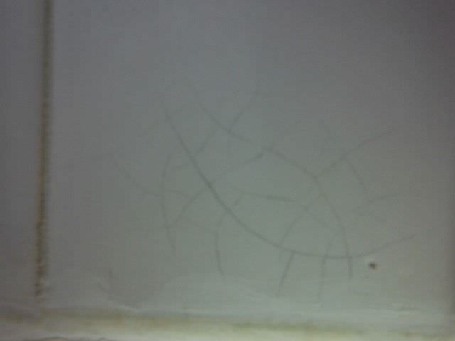

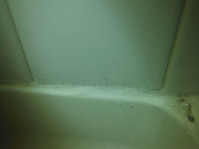

Denray Posted November 22, 2016 Report Share Posted November 22, 2016 Anyone know what causes these marks on tile? Click to Enlarge 17.05 KB Click to Enlarge 14.63 KB Link to comment Share on other sites More sharing options...
Denray Posted November 22, 2016 Author Report Share Posted November 22, 2016 They don't seem to be cracked, yet? Are cracks on the way? It's tile. Link to comment Share on other sites More sharing options...
kurt Posted November 22, 2016 Report Share Posted November 22, 2016 I misread the original...they're tiles, not cheap plastic. Tired.... Cheap tile with micro fissures. They won't crack all the way, they'll just keep getting shittier looking. Link to comment Share on other sites More sharing options...
Denray Posted November 22, 2016 Author Report Share Posted November 22, 2016 Most excellent. Thanks Kurt! Link to comment Share on other sites More sharing options...
Bill Kibbel Posted November 22, 2016 Report Share Posted November 22, 2016 The cracks are only in the surface glazing. Google crazing. Link to comment Share on other sites More sharing options...
Denray Posted November 23, 2016 Author Report Share Posted November 23, 2016 There's a long horizontal fine crack about 4 feet up which seems to be on a high spot of that plane. I better recommend tile boy check it all out. Thanks Bill. Link to comment Share on other sites More sharing options...
mjr6550 Posted November 23, 2016 Report Share Posted November 23, 2016 Check to see if the tile has been painted. I have seen similar cracks with painted tile. Link to comment Share on other sites More sharing options...
kurt Posted November 23, 2016 Report Share Posted November 23, 2016 There's a long horizontal fine crack about 4 feet up ....... Where the guy installing cheap tile didn't tape or otherwise secure the cheap substrate seam (probably greenboard).... I'd do nothing until I did it all, meaning live with it until I stripped it to the studs. Link to comment Share on other sites More sharing options...

inspector57 Posted November 23, 2016 Report Share Posted November 23, 2016 Different take... The cracks look like they go across the caulk/grout line at the bottom to me. Could the tile have been refinished and it is the finish that is cracking? Link to comment Share on other sites More sharing options...
