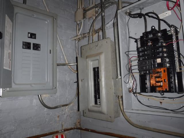

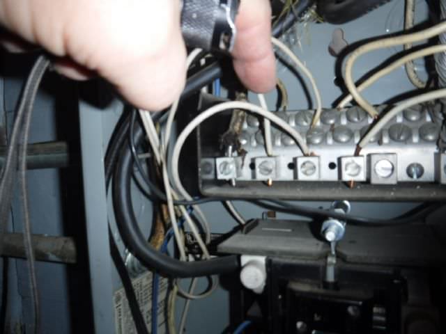

Mike Lamb Posted November 19, 2016 Report Posted November 19, 2016 A wire is running from the neutral bus on the far left panel to the neutral bus on the middle panel. These are all main panels in a multi-unit building. All the panels were bonded together with metal conduit. Is this okay? Click to Enlarge 49.55 KB Click to Enlarge 36.62 KB Click to Enlarge 44.82 KB
Marc Posted November 20, 2016 Report Posted November 20, 2016 Absolutely not. It creates a parallel path for neutral currents between the two panels. That small, it's a fire hazard. Marc

Jim Katen Posted November 20, 2016 Report Posted November 20, 2016 I have no idea why someone would do that or what purpose it might serve. However, I doubt that it's going to cause any harm. The neutral bars on all three panels should be connected through the grounding electrode system and through their multitude of conduits, as you observed. That said, it's not a good thing. It's undoubtedly carrying some unintended current and that's not desirable.
Marc Posted November 20, 2016 Report Posted November 20, 2016 I have no idea why someone would do that or what purpose it might serve. However, I doubt that it's going to cause any harm. The neutral bars on all three panels should be connected through the grounding electrode system and through their multitude of conduits, as you observed. That said, it's not a good thing. It's undoubtedly carrying some unintended current and that's not desirable. If the arrangement here is that the panels each have main disconnects, wouldn't the electrode grounding system still be bonded at only one location? The concern is that little jumper between neutral buses is parallel to the much larger neutral conductors upstream of the panels. Break that neutral path and that little wire takes over, at least until it melts. Marc
