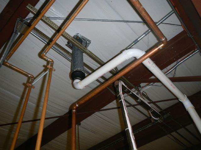

Mike Lamb Posted November 19, 2016 Report Posted November 19, 2016 I thought I read somewhere that B vents cannot be used with cat 4 furnaces but can't find such a reference. Is it okay to connect PVC to a B vent?
Bill Kibbel Posted November 20, 2016 Report Posted November 20, 2016 Is it okay to connect PVC to a B vent? Nope. IRC sez vent material "as specified by the manufacturer". All manufacturer's of cat IV furnaces will specifically exclude B-vent. Just did a building where 10 space heating units were just replaced with cat IV furnaces. I'm guessing the installer didn't want to change the B-vents through the roof. Click to Enlarge 48.66 KB Click to Enlarge 25.34 KB
Hearthman Posted November 20, 2016 Report Posted November 20, 2016 B-vent listed to UL 441 for CAT I appliances only. No positive vent pressure. Natural draft only. Positive vent pressure appliances must vent into pipe listed for positive vent pressure, which is UL 1738 or PMI, which is where the illegal use of PVC comes from. PVC has never been approved for venting in the US by UL nor by IAPMO nor any mfrs. I'm aware of. Still allowed though by IRC for now.

Jim Katen Posted November 21, 2016 Report Posted November 21, 2016 I just checked some installation instructions; Trane says you can use: PVC F891 (cellular core), D2665 (DWV pipe), D1785 (Sch 40, 80, 120), or D2241 (SDR series). CPVC D2846 (CPVC41), F441 (Sch 40, 80), or F442 (SDR series).ABS D2661, F628Carrier says you can use the same things. Goodman says you can use 1785, D2465, or D2266. What am I missing?
Hearthman Posted November 21, 2016 Report Posted November 21, 2016 Re-read my first post. I said the IRC still allows it. This, however, is a contradiction because the code also says all positive pressure venting must be listed. They can't make their minds up. These appliance mfrs. say its ok to use this pipe but the pipe mfrs. and other agencies say don't do it. That's all. Fernco says don't use their neoprene couplings for combustion venting but sells them to water heater mfrs. for use on power vented models included with the unit. Go figure.
Jim Katen Posted November 21, 2016 Report Posted November 21, 2016 Re-read my first post. I said the IRC still allows it. This, however, is a contradiction because the code also says all positive pressure venting must be listed. They can't make their minds up. These appliance mfrs. say its ok to use this pipe but the pipe mfrs. and other agencies say don't do it. That's all. Fernco says don't use their neoprene couplings for combustion venting but sells them to water heater mfrs. for use on power vented models included with the unit. Go figure. So the IRC allows it and the furnace manufacturers allow it - heck, they *require* it -- but the pipe manufacturers prohibit it. Yes? If that's the case, and given that there are millions of these installations out there performing just fine, my decision, as a home inspector, is not to wade into that particular field of weeds. When you get the manufacturers and the IRC to realize the folly of their ways, let me know and I'll be happy to hop on board.
kurt Posted November 21, 2016 Report Posted November 21, 2016 Fernco isn't neoprene. It's flexible PVC. It's pretty neat stuff. Pipe manufacturers not approving it sounds more like corporate legal limiting class action exposure than any inadequacy of the material. Pretty much standard strategy in materials manufacturing.
