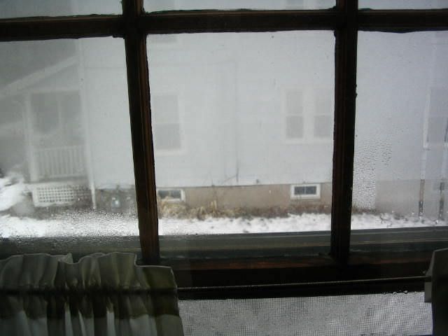

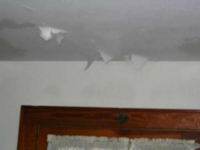

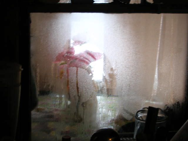

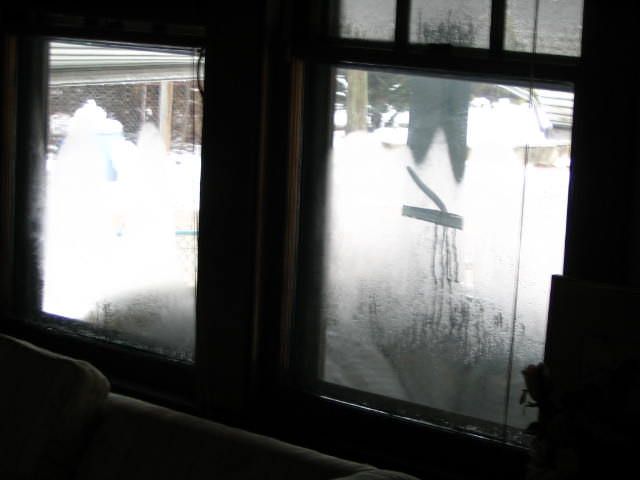

Wayne Wildermuth Posted January 5, 2006 Report Posted January 5, 2006 I was called to consult on a house that had water on the interior walls. When I got to the house, there was water on the walls, windows, floors and ceilings had peeling paint. Conditions - the house is a 1930s two bedroom cape of about 700sf. It has a walk up attic with minimal insulation in the floor of the attic, walls of house unknown. The attic has two windows, one on each end. The attic is an open area and has three beds in it and the area is heated with a portable electric oil space heater. There are ten people living in the house. It is not a typo, there are 10 people living in this two bedroom one bath house! There is only one bathroom (and as a side note, the shower walls are made of sheetrock and not the moisture resistant kind either, not that it would make a difference) anyway, no vent in the bathroom. Heating is with a steam boiler that is only used at night when they sleep and shut off during the day (not turned down, but shut off). No burst plumbing pipes were found. The windows are double hung, single pane with varying degrees of glazing deterioration. Walls are a mix of sheetrock and plaster with both oil based and latex paint. Some paint is peeling off the ceilings. Roof covering is asphalt shingles and is deteriorated but no staining is seen on the sheathing from the attic area. The fibrous siding is in fairly good shape. Ice is forming on the edges of the roof where the gutters are full of ice. Ice damming is occurring. Problem - water is collecting on the interior window glass of all doors and windows including the ones in the attic. Water is on most of the interior outside walls from about the top of the windows down and is running down the walls to the floor and in some area beyond into the basement and down the concrete basement walls. Interior inner walls are dry. Most window sills are soaked with water. A mold type substance is growing on most of the walls where the floor molding meets the wall. Initial conclusion - There is not adequate ventilation of the interior portion of the house. That many people taking showers, cooking, breathing, sweating or whatever, along with a steam furnace adding moisture to the air with the steam release vents on each radiator and the attic being heated and closed up are all contributing to the moisture being put into the building and not being allowed to exit. The condensation is building up on the windows and walls and dripping down. Just like dew on grass in the morning, when the steam heat is run overnight, moisture builds up inside the house and is clinging to windows and such, but unlike the sun drying the grass, in the morning the moisture is not dried by the heating system of the house during the day because it is shut off. It then stays as dew all day and is added to the following night and the cycle continues. Input - Does this make sense? I am looking for other possible causes of this. Will a whole house fan fix this? If you have any other thoughts that may be causing this condition, or how to fix it, please post a reply.

Wayne Wildermuth Posted January 6, 2006 Author Report Posted January 6, 2006 I am also going to have them check the chimney for proper operation/blockage. CO may be going into the house and may be adding to the problem. Here are a few pictures....hope you can see them. Download Attachment: IMG_0808.JPG 40.49 KB Download Attachment: IMG_0812.JPG 43.18 KB Download Attachment: IMG_0815.JPG 32.03 KB Download Attachment: IMG_0826.JPG 38.47 KB Download Attachment: IMG_0827.JPG 22.27 KB Download Attachment: IMG_0829.JPG 34.08 KB

BADAIR Posted February 14, 2006 Report Posted February 14, 2006 The photo with the ceiling paint peeling should also be of concern for lead. We know it's there just hasn't been tested or has it?
