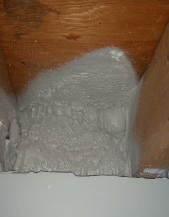

CORJB Posted November 8, 2016 Report Share Posted November 8, 2016 We had a basement room which has 2 outside walls sprayed with type 2, closed cell spray foam this summer. The room was stripped bare and re-studded before the spray. The walls were gyprocked, primed & painted but the ceiling is yet to be finished. We experienced the typical fish smell which dissipated as expected a few days later. We use the room as a craft shop and have had no smell issues until last week. All os a sudden that fishy smell is back and its definitely coming from that room. Yesterday we opened the basement door and installed a box fan in the patio door to try and vent-out the odor. The odor persists. I have read about this problem and it is often labelled as an application error or batch failure. What I have not been able to find is whether this problem will resolve itself eventually and in about how long. I understand crudely that the technician mixes product A + B = C but that in bad applications, the A&B remain "uncompleted" therefore the foam doesn't go through the normal cure and hence the smell. I also noticed that a small portion of the foam is a bluish color compared to the regular yellow foam. In the attached pictures the regular foam is on the left, blueish on the right, bottom pic is regular yellow foam) I have contacted the company that did the spray and the guy seemed completely surprised and as if this had never happened before. He's supposed to come by the house but hasn't showed. I'm worried (can you tell?!) about what I'm breathing. Why is it smelling now, months later? We have a heat pump but nothing should be heating that foam to explain the smell. The humidity is below 40%. I would appreciate your input. Click to Enlarge 13.02 KB Click to Enlarge 17.57 KB Click to Enlarge 13.44 KB Link to comment Share on other sites More sharing options...

CORJB Posted November 12, 2016 Author Report Share Posted November 12, 2016 Closing the HVAC vent in the room brought the smell down to nearly undetectable levels. We just re-opened that vent this morning & a few hours later the smell is more noticeable. We removed the section of vent that is feeding into that room to check for any irregularities (there were none) and cleaned it for good measure. My installer came by while it was (of course!) nearly smell-free. He could not smell anything. I asked him about the color differences he said the darker foam is Johns Manville and the rest of the room is Enerlab. He did not explain why that was. He speculated that maybe some water had infiltrated behind the foam (the room is in a basement) and "pushed the smell out" He wet some surface samples of each to see if they smelled more. They did not smell more while wet but the darker, Johns Mansville foam had a smell to me that he could not detect. Its my understanding that closed-cell foam is waterproof so it seems like an unlikely reason to me. He said that he's done thousands of jobs and has never had this happen. That his equipment is electronically calibrated and so it makes it impossible to apply the foam off-ratio. He was to talk to his supplier and get back to me. He suggested as a last recourse that we could have an indoor air quality lab run tests to determine if there's another cause. Link to comment Share on other sites More sharing options...
kurt Posted November 13, 2016 Report Share Posted November 13, 2016 Sounds exactly like my experience. Installer dumbfounded, "never had it happen before", all the same explanations about electronically calibrated equipment making it impossible to screw up, etc..... And, it isn't water "pushing the smell out". The stuff is water resistant, as you note. It eventually got around to tearing stuff out, and we found elongated weird gooey spots with a few globs. No reasonable explanation was ever determined. We don't know why it went bad, but it went bad. Link to comment Share on other sites More sharing options...
