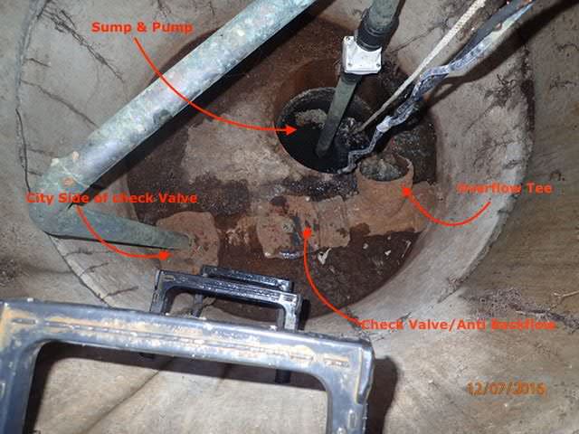

kurt Posted December 6, 2016 Report Posted December 6, 2016 It's not technically a caisson; it's just a manhole about 6' deep. The building sewer runs through it. When there's back up, the primary check valve closes to prevent shit from backing into the house. If someone flushes, it goes into an overflow sump in the "caisson" with a pump to pressure inject it into the City side of the primary check valve. The rest of it is like you describe. I got a picture somewhere.....
kurt Posted December 7, 2016 Report Posted December 7, 2016 Here....this is the view from the top. Nasty. Click to Enlarge 67.8 KB
