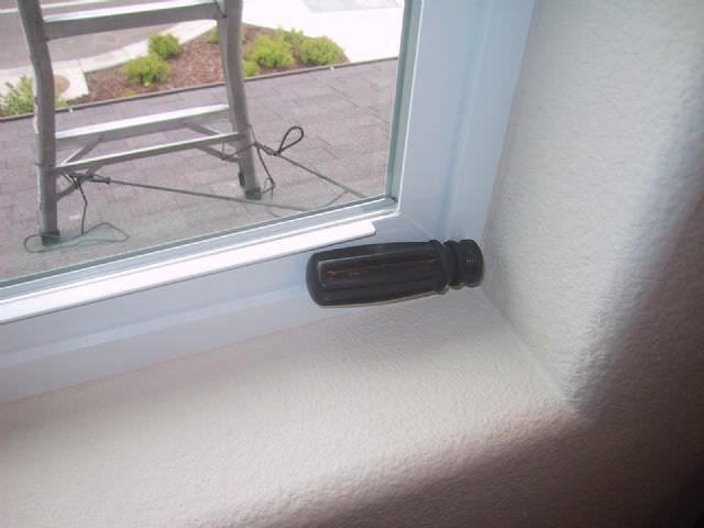

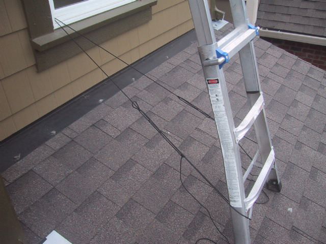

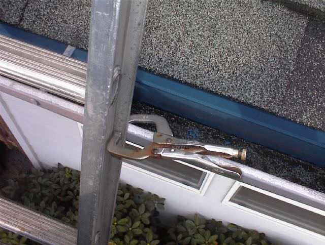

Ascending is rarely a problem. It's descending that's the bitch. That first step from the roof to the ladder is where it can all go wrong.
I've posted this before, but it's worth repeating. Get a small welding clamp and pin your ladder to the gutter. It makes the ladder rock solid and is way better than a bungee cord.
Maybe the single most useful and cheap safety tip going.....screw bungees...

Yes, Jim, I stated that backwards...descending is always the harder part. Thanks for posting the pics, by the way. I like your tie-down methods, both top and bottom.
Thanks for the invite, Les. We'll definitely have to get together sometime.
As for the ladder, over the top when I can. Maybe using a vice grip on a gutter will give me a better appreciation for the side approach.

Yes, I have had the 24' ladder fall sideways in a gust of wind while I was walking the roof. But I was lucky that time because it hung up on a scupper drain and I was able to wrestle it back up for the climb down. A buddy had to call the fire dept once when he lost his ladder. A bungee cord or clamp would have been good for all of those scenarios.
