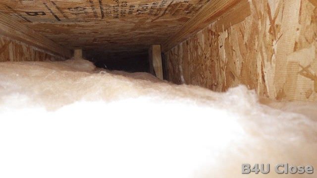

Erby Posted September 13, 2016 Report Posted September 13, 2016 Click to Enlarge 31.58 KB My understanding is that insulation is supposed to be installed in contact with the sub floor. I commonly find it installed in I-Joist floors hanging on wires supported by the bottom flange of the I-Joist, leaving a gap (as seen in the picture above) between the insulation and the floor. What do y'all say about htis.
Marc Posted September 13, 2016 Report Posted September 13, 2016 The gap allows the development of convective air currents within that area but I can't see how that would be detrimental. Convective losses through fiberglass insulation is going to happen regardless of whether there is a gap above it or not. Marc
Jim Katen Posted September 13, 2016 Report Posted September 13, 2016 Read all about it here: https://buildingscience.com/documents/i ... 2520floors

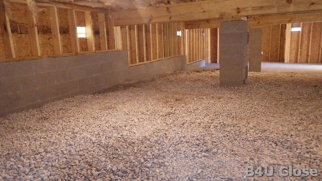

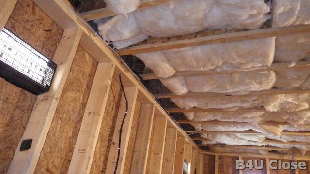

Erby Posted September 13, 2016 Author Report Posted September 13, 2016 Yeah, I read that last night too! However, Joe's solution includes rigid insulation or drywall on the bottom of the joists. That ain't going to happen in a crawl space here. They don't even fully insulate the ends of the joist bays. Click to Enlarge 49.38 KB Click to Enlarge 60.65 KB Nice crawl space though. I wish all of them were like this.

David Meiland Posted September 15, 2016 Report Posted September 15, 2016 The gap allows the development of convective air currents within that area but I can't see how that would be detrimental. The issue is that the air gap above the insulation communicates with the rim joist around the entire perimeter of the floor. When it's cold outside, a lot of heat is lost at the perimeter. I can't remember the DOE's exact numbers, but insulation with an air gap above it suffers significant performance degradation.
Jim Katen Posted September 15, 2016 Report Posted September 15, 2016 The gap allows the development of convective air currents within that area but I can't see how that would be detrimental. The issue is that the air gap above the insulation communicates with the rim joist around the entire perimeter of the floor. When it's cold outside, a lot of heat is lost at the perimeter. I can't remember the DOE's exact numbers, but insulation with an air gap above it suffers significant performance degradation. If the gap is open at the ends, the performance degradation is 100%.
