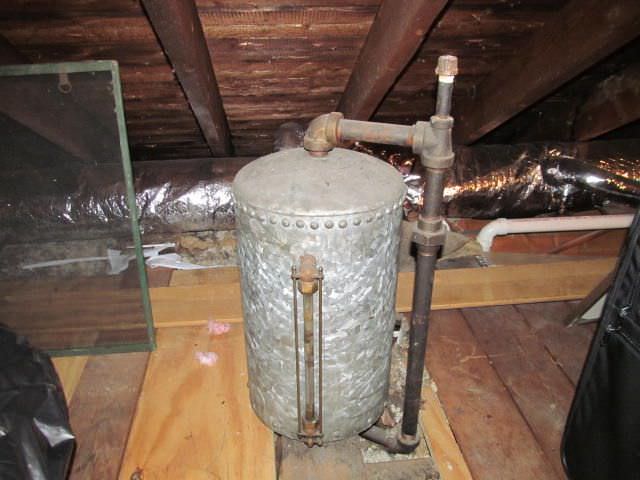

Rob Amaral Posted July 24, 2016 Report Posted July 24, 2016 Click to Enlarge 52.28 KB Oddly, 'still connected'...
Jim Katen Posted July 24, 2016 Report Posted July 24, 2016 For those who know about these things, is there a purpose to the small nipple at the top right side? Why didn't the installer just use an elbow there?
Chad Fabry Posted July 24, 2016 Report Posted July 24, 2016 I'm not sure why that one is installed that way, but if I did it like that it would be to let air out of the system as I filled it or to let air into the system as I emptied it.
Tom Corrigan Posted July 24, 2016 Report Posted July 24, 2016 The pipe originally continued to the atmosphere. Either through the roof, into a stack pipe or back down to the basement and near a floor drain. You opened the manual fill valve in the basement until the water ran from the pipe (or off the roof). The cap was added when the system was converted to a closed and pressurized system. Tom Corrigan
Tom Corrigan Posted July 24, 2016 Report Posted July 24, 2016 I should also be mentioned that most of these were at risk of freeze damage once we learned to insulate the attic floor and vent the attic. Was it still connected? If so, the buyer should be made aware of the risk. Tom Corrigan
Hearthman Posted July 24, 2016 Report Posted July 24, 2016 The gage glass often froze first. Yes, the nipple was a vent. Circulator pumps didn't come about until 1923 and the widespread conversion to oil fired burners. Prior to that hydronic heating was gravity as noted by the large diameter pipes. If the upstairs rooms don't get enough heat have a technician drain the system and inspect for an orifice plate used to force more hot water into lower floor rads by gravity. Often those orifices weren't removed once converted over to forced circulation.
Jim Katen Posted July 25, 2016 Report Posted July 25, 2016 The pipe originally continued to the atmosphere. Either through the roof, into a stack pipe or back down to the basement and near a floor drain. You opened the manual fill valve in the basement until the water ran from the pipe (or off the roof). The cap was added when the system was converted to a closed and pressurized system. Tom Corrigan Thanks, Tom
Rob Amaral Posted July 25, 2016 Author Report Posted July 25, 2016 It was still in use... I told the client to 'remove it'.. 'not needed/frost-prone', etc ,etc.. Oddly, the house had a modern-vintage Buderus boiler.. you'd think the heating contractor would have made sure this was done at the time of installation of that boiler.... (No.. it was not "Rich Trethewey", though we see thousands of his company's work all the time around 'heeyah'... File under: Never Assume Anything.. I find tons of these all the time of course.. but never connected..
