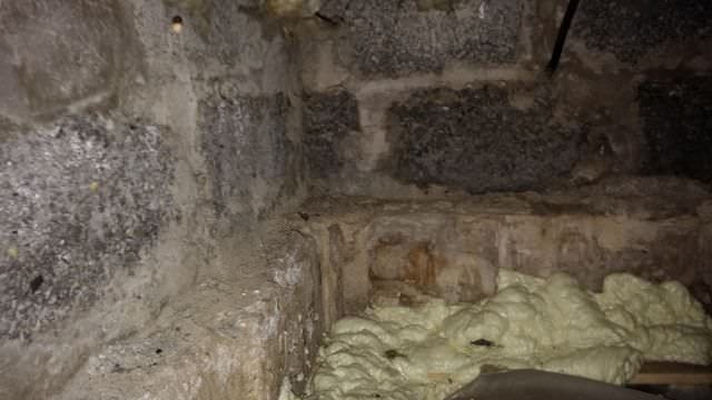

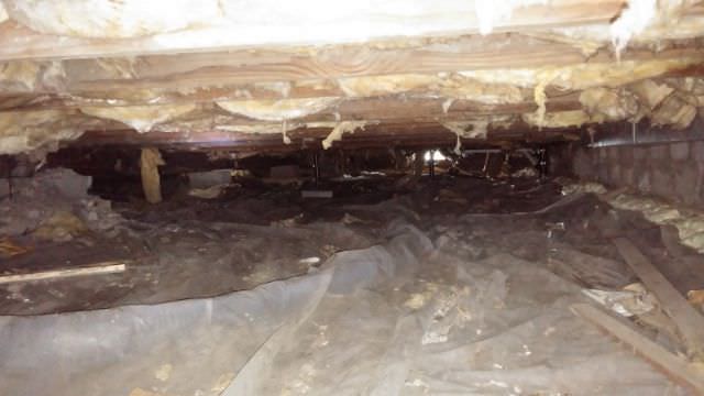

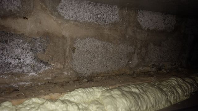

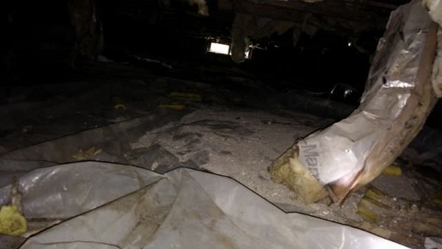

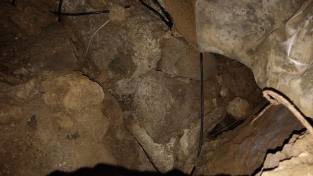

pyralis Posted June 12, 2016 Author Report Share Posted June 12, 2016 Hello again everyone. Sorry in advance for the lengthy post. So I went down into the crawl space today to get some pictures. Unfortunately, I found something that I think might be a much bigger deal than high humidity and this time I have absolutely no idea what to do. As I was crawling through the space, at one point I ended up putting my hand down in a spot and nearly fell into a "hole" that you will see below. the vapor barrier covering it looked like it was two pieces overlapping each other and weren't even sealed as far as I can tell. I don't think I ripped it when I hand went into it, but I'm not positive. Click to Enlarge 34.44 KB Click to Enlarge 30.32 KB Click to Enlarge 41.09 KB Click to Enlarge 40.23 KB I was quite shocking and a bit dumbfounded to say the least. I tried my best to cover the hole back up with the barrier. I continued on through more of the crawl space and noticed an area that the vapor barrier was sinking into and this time had a large rip but was wrapped over itself. Low and behold, another "hole". It isn't that far from the other hole btw. I couldn't really get a good picture of this one because of angle and lack of light. Click to Enlarge 23.26 KB At this point I am now freaking out. I got some more pictures and got out as quick as I could. I am no expert in the slightest bit, but they look like sink holes and it looks like there are water channels at the bottom. I didn't have any kind of measuring tape, but they have to be at least 6+ feet deep. Anyone have a clue what is going on here? And who would I even call? A structural engineer? I am at a complete loss now. As for rest of the crawl space. I've upload some more pictures below. I also used my new moisture meter and the majority of the wood I tested is ranging from 20-24% moisture, which I know is way too high. John, thanks for all the suggestions to check for. I checked a few things, but after getting out of the crawl space I just couldn't do any more. FYI, this was a flip house. It was bought by a investment company in a short sale and they basically ripped it apart and rebuilt the innards. The electrical panel is indeed new. 90% of the wiring is new as well. They moved everything from the crawl space into the attic (HVAC, duct work, electrical) The hood fan over the stove does indeed have a metal pipe that runs into the attic and out the roof. The vent is it's own and the opening is covered with mesh wire or something so stuff doesn't get in. I think the water pipes are copper, but I'm not really sure. I insulated them shortly after moving in since they are still in the crawl space. I checked various spots both inside and outside the crawl space with the screwdriver. Hard as a rock. Didn't go into anything. And funny thing about the downspout in the back. When we first looked at the house we saw that and kind of scratched our head trying to figure out why that was there. It was the first thing we did after buying the house. We removed that downspout, patched the hole in the gutter, and increased the size of the other downspout that runs into a pipe which goes into the ground and out towards the street. Again, thanks you all so much. I am trying to calm myself down and be positive that it might not be as bad as I think, but it's not working too well. Click to Enlarge 44.94 KB Click to Enlarge 30.67 KB Click to Enlarge 35.65 KB As you can see here the barrier is pulled away from the foam spray. There are many locations where this is happening. I think a lot of damage and movement happened when they were working down there prior to our purchase. Click to Enlarge 36.25 KB Click to Enlarge 29 KB Click to Enlarge 37.01 KB Click to Enlarge 34.62 KB Click to Enlarge 54.71 KB This is around one of the concrete supports. Again, the barrier wasn't attached to anything. Click to Enlarge 29.47 KB There are various spots that have a lot of debris. Almost like crumbled drywall or something. But I don't know why that would be under the floor. Click to Enlarge 23.88 KB Click to Enlarge 27.43 KB Click to Enlarge 41.66 KB Click to Enlarge 34.78 KB Click to Enlarge 34.25 KB Click to Enlarge 37.14 KB Here you can see there is definitely moisture/water under the barrier. There are a couple specific corners in the back of the crawl space where I see this. Click to Enlarge 36.44 KB The greenish looking crap you see is insulation of some sort that they had stuffed behind one of the vents. Since the rest were open I figured that one should be as well. Thank you all very much! Link to comment Share on other sites More sharing options...
Marc Posted June 12, 2016 Report Share Posted June 12, 2016 Sinkholes. The cause likely depends on local geographics. In my area, they're a result of ancient steel sewer tanks long covered and forgotten by an addition to the house. Sometimes, it's abandoned, broken sewer or stormwater drain lines. Marc Link to comment Share on other sites More sharing options...
pyralis Posted June 12, 2016 Author Report Share Posted June 12, 2016 Thanks Marc. That's what I was thinking. Do you know who I would call for something like this? I assume I would need it checked out before I have it filled. Link to comment Share on other sites More sharing options...
Marc Posted June 12, 2016 Report Share Posted June 12, 2016 There's a couple folks here from your general area who might be able to help with that. Maybe wait for them to chime in. I wouldn't backfill them before I learned the reason why they're there in the first place. You don't want them coming back. Marc Link to comment Share on other sites More sharing options...
kurt Posted June 12, 2016 Report Share Posted June 12, 2016 Yes, the vapor barrier part just dropped down the priority scale. I'd call Kibbel. Link to comment Share on other sites More sharing options...
pyralis Posted June 12, 2016 Author Report Share Posted June 12, 2016 Thanks guys. I'll be checking back probably every hour to see if one of those in my area has posted. Kurt, who is Kibbel? I tried doing a search but nothing that stands out as a company in my area who would deal with this kind of problem. Link to comment Share on other sites More sharing options...
kurt Posted June 12, 2016 Report Share Posted June 12, 2016 He's a Principal @ Tri County..... http://www.tchomeinspectors.com/historic.htm Link to comment Share on other sites More sharing options...
John Kogel Posted June 13, 2016 Report Share Posted June 13, 2016 I agree from the first pics it looks like water has flowed under there, but all seems to be dry now. Also on the positive side, the house has stood firm for 60+ years, and the perimeter walls appear to be plumb and stable. Even so, there could be a seasonal spring that fills those holes every winter. The last hole in your first set of pics looks like it is hand dug, square sides. And there is no water in the bottom of it. Might be an old sump pit or somebody's planned sump pit. I see a lot of your pics show typical stuff for a 1950's crawl. If the wood is all sound, you can focus on that little creek bed. Good luck. Link to comment Share on other sites More sharing options...
mjr6550 Posted June 13, 2016 Report Share Posted June 13, 2016 The first set of photos is not very clear. From your description and some of the other photos it does look like you have concerns. A structural engineer would be your best choice. Link to comment Share on other sites More sharing options...
