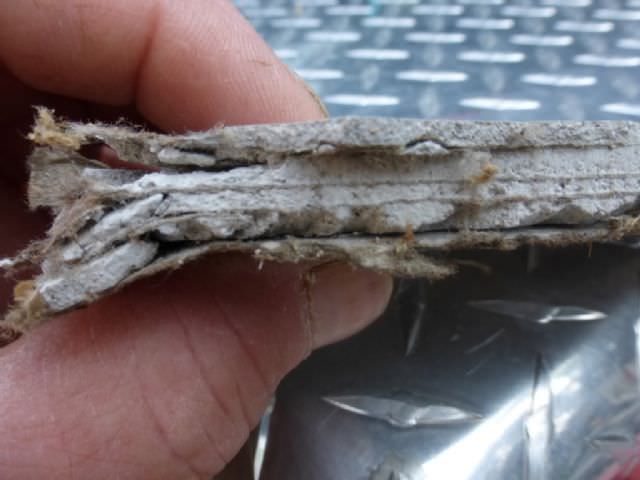

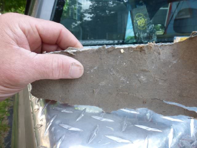

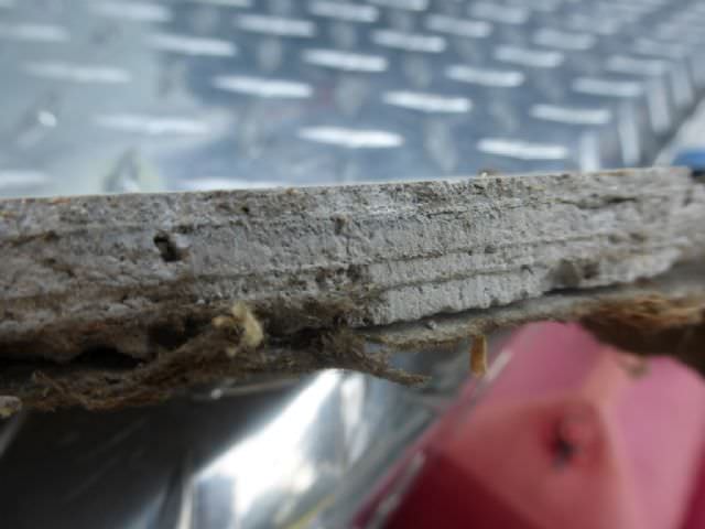

Chad Fabry Posted May 28, 2016 Report Posted May 28, 2016 The house is difficult to date- I'm guessing 1860-1870. I found the wallboard pieces in the basement below an interior parting wall where the remodeler thought he was discreetly disposing his demo debris by dropping it into the wall cavity. The board is comprised of four 1/8th inch alternating layers of paper and plaster. It's strong and it's heavy. Click to Enlarge 41.98 KB Click to Enlarge 36.96 KB Click to Enlarge 47.61 KB
Jim Katen Posted May 28, 2016 Report Posted May 28, 2016 I've never seen or heard of such a product. It looks like a great idea though. Kind of like gypsum plywood. In the area of New England where I grew up and got started in construction, it was very common to find all kinds of crap inside wall cavities. For some reason, people threw old shoes in there - I have no idea why. They were usually worn out and mismatched, but we'd sometimes find a whole wall full of them. In the 1990s, I seem to recall an article in JLC about a drywall contractor who advocated slicing all scrap drywall into 14-inch wide pieces and stacking it in the wall cavities. He claimed it helped to deaden sound and it cut down on the waste that he had to haul away.
BADAIR Posted May 28, 2016 Report Posted May 28, 2016 dated earlier than Sackett board https://www.gypsum.org/about/gypsum-101/history-gypsum/
Chad Fabry Posted May 29, 2016 Author Report Posted May 29, 2016 Thanks Barry, It sounds like Sackett board. The house has an 1840-1850 core and several other late 19th century additions. I can see a circumstance where this stuff could have been installed. I have an 18 inch square of it.... it's definitely plaster layered between paper. As I said before, it's amazingly strong.
