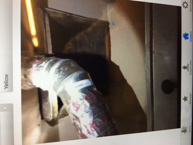

Tspivey0534 Posted May 24, 2016 Report Posted May 24, 2016 I inspected a house today that has a Luxaire gas furnace- the filter is located on the top- I think we are missing the plenum box that connects the lower furnace cabinet to the upper ceiling opening- I spoke to the contractor who installed the unit- he said that you don't have to have the upper box- it allows for better air flow- the closet door is vented appropriately- Wondering if this was correctly installed Download Attachment: IMG_3254.JPG 77.53 KB
Marc Posted May 24, 2016 Report Posted May 24, 2016 I can't fathom an upflow gas furnace that has the conditioned air filter at the furnace discharge. Is this a downflow unit? Marc
Bill Kibbel Posted May 24, 2016 Report Posted May 24, 2016 Too little info given. I'll assume the duct above is the return air duct since you said the filter was on top. It's obviously not a direct vent furnace. Even with a louvered door, combustion byproducts can be pulled out of the system and into the return air opening of the furnace. Also, the louvered door was intended for replacement air for combustion - it's not a large return vent. I'd guess the lazy-ass contractor replaced a furnace without bothering to connect it to the existing return duct system.
Tom Raymond Posted May 25, 2016 Report Posted May 25, 2016 Is the water heater also in this closet? I had one like that where the open return plus combustion pulled the flame out the burner covers on the water heater. If the CO didn't kill them the house fire surely would.
