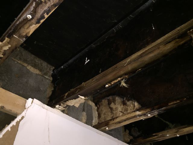

A pic from today... We opened it up because there was a soft spot in the roof sheathing. The truss are rotting in their pockets.
Anyone feel free to use this pic to get the word out.

So what is to blame here? The split face block or lack of parapet flashing? Or both? Any other issues at the lower levels?
I did talk to Kelly a few months ago about installing rain screens and he told me it is too difficult to get a straight wall over the rough surface of the SFB. He feels that ventilating the top of the parapet and cutting out any through wall flashing should solve the SFB problem. It could work but I feel it is a shot in the dark.
Posted
Everything is to blame. There's a lot of details at every step of the process that have to be right, and none of these things are even close. It's not the block; it's the installation. Not a one of them has back dam flaps, end dams, they use that crap IPCO plastic garbage bag membrane, the wicks are just plugs in holes that are too small and too few, the coping sags and water flows around the edges, there's no expansion joints, etc., etc. They're all ****ed up, and there are thousands of them.
And, it's not just split face. We're opening up cavity wall that's sopping wet. Why? Because the mopes at Local 21 are sure they know now to lay brick, and they **** it all up.
Kelly's not a shot in the dark. The stuff works. No one wants to believe it. So, we're changing people's minds one building at a time. We got buildings that prove it works.

And a lot of these split block places have crawlspaces and either from wall moisture or damp rise from the foundation the ends of the joists with no capillary separation are sucking water and rotting. You are right when you say the problem is everywhere.
One of the few SFBs I have looked at where I couldn't find any signs of moisture had a pitched shingled roof with soffit and gutters.

.. that is a nasty-case there... commercial or residential???
Residential. Built in the boom. We're finding that anything, and I mean darn near everything....be it SFB or conventional cavity wall....built from 1998 to 2008-09, has water issues at some level. The codes are wrong. The masons are wrong. The principles, materials, and methods....it's all wrong. We're getting used to the idea that people think we're completely nuts.
I'm getting really gun shy looking at these things. We've opened up too many of them, and I know too much. In conventional brick veneer, it's at least repairable by standard carpentry and redo the veneer. In load bearing cavity wall, it's the whole damn structure. And this one isn't even all that bad.

Anyways, Kurt, I am curious as to how the repairs are going to be made.
Kelly designed a metal bracket/joist hanger specific to these conditions. We've got an engineer working up the spec's now. It may be part of the Wick Right package.
