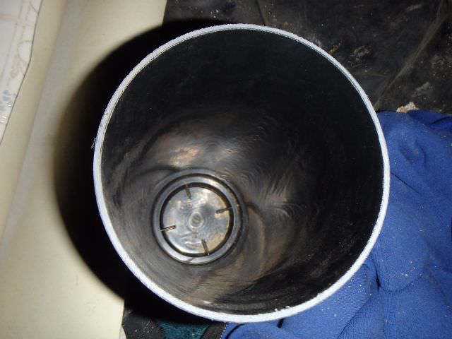

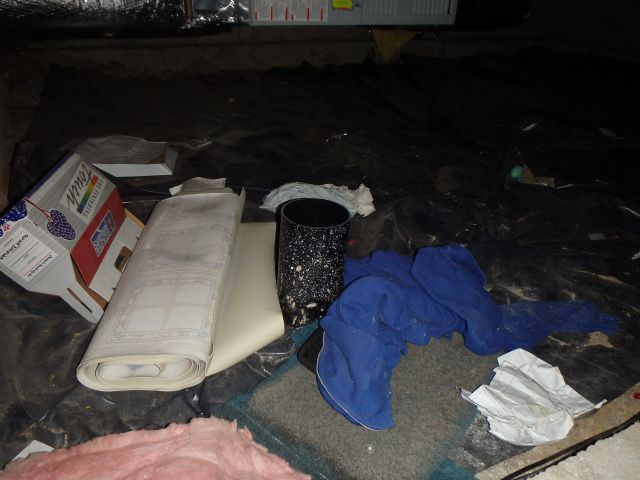

I came across this black short pipe in the crawl space. It was located near the access door away from any plumbing pipe. Possible future Radon system??

That is a back flow prevention valve. It's in the main waste line to prevent municipal sewer line backups from coming into the house. Although you may not see a waste line exposed near it, the line could travel out of the structure under the grade in that area.
Posted
The pipe sticking up out of the ground is just a pipe.
The thing at the very bottom of the pipe is the cover from a backwater valve, as John described. I don't see how anyone can actually open the cover in this situation. Someone should excavate a larger hole and put in a sump liner or something with a little elbow room in place of the pipe.
