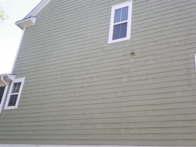

palmettoinspect Posted April 27, 2016 Report Share Posted April 27, 2016 Came across some weird stains on this house today. I've never seen anything like it. It's just on one side of the home. This side faces south east and doesn't get much sun. Does not appears to be from sun damage. Home is about 4 years old. Anyone seen anything like it? Thanks, Kiel Click to Enlarge 41.96 KB Click to Enlarge 31.1 KB Link to comment Share on other sites More sharing options...
Scottpat Posted April 27, 2016 Report Share Posted April 27, 2016 Very strange? I can't say I have seen that before, but it looks like the spots also follow the framing to some extent. Over by the window it looks like the spots are lining up on the wall stud. My SWAG would be vapor migration, could be bad WRB or no WRB. Link to comment Share on other sites More sharing options...
John Kogel Posted April 27, 2016 Report Share Posted April 27, 2016 Either your compass is out of whack or the sun is shining down from the North. No matter, we get the general drift, shady wall. My guess is somebody sprayed the wall to wash it and didn't rinse the sludge off very well. But, no, never seen that pattern before. Link to comment Share on other sites More sharing options...
Jim Baird Posted April 27, 2016 Report Share Posted April 27, 2016 I share John's disoriented feeling re the sunlight. Never seen anything close to this. If this house is on the coast and went through Charleston's record rains of last year, I might guess there is no WRB and that the wall might have suffered some wind driven moisture intrusion. As an AHJ some yrs back I busted a hurry-up spec builder putting up cement fiber siding without wrb about halfway through the job. The siding came down and he started over again. Link to comment Share on other sites More sharing options...
Marc Posted April 27, 2016 Report Share Posted April 27, 2016 ... As an AHJ some yrs back I busted a hurry-up spec builder putting up cement fiber siding without wrb about halfway through the job. The siding came down and he started over again. He lost that siding, did he? Far as I know, it can't be removed without destroying it. I've never seen spotting like that. Marc Link to comment Share on other sites More sharing options...

mjr6550 Posted April 28, 2016 Report Share Posted April 28, 2016 Just checking-do all your photos have the same stains? Link to comment Share on other sites More sharing options...
palmettoinspect Posted April 28, 2016 Author Report Share Posted April 28, 2016 Just checking-do all your photos have the same stains? Yes, they all do. The stains are clearer in person and do not show up as well in the pictures. Link to comment Share on other sites More sharing options...

mark parlee Posted May 3, 2016 Report Share Posted May 3, 2016 Is there a WRB applied under the siding? If so what brand, if you can tell. Link to comment Share on other sites More sharing options...
palmettoinspect Posted May 3, 2016 Author Report Share Posted May 3, 2016 Is there a WRB applied under the siding? If so what brand, if you can tell. From what I could tell looking behind the perimeter band board at the bottom edge there was. I could also see the blue colored OSB wall sheathing edge and it was in good shape. I could not determine the brand of the WRB. This appeared to be a pretty good install. It's a Pulte/Centex home and they tend to build decent houses around here. I'd be very surprised if they forgot the WRB, but I guess anything is possible. Link to comment Share on other sites More sharing options...
mark parlee Posted May 3, 2016 Report Share Posted May 3, 2016 I have seen some of this staining before when the WRB was left off and moisture got behind the siding. We have had it at the top of the wall when there are humidity issues in the home in the bathroom areas. this has in my experience been a cold weather problem with high indoor humidity and a not very well sealed wall envelope. The air moves from warm to cold and wet to dry. Warm indoor dry air is wetter than exterior cold wet air, the vapor pressure is outward in the winter. In an area such as a bathroom where the exterior wall is not sealed well, this can be an area prone to moisture forming on the wall under the siding and running out the laps of the siding. Sounds crazy but I have been called to look at several of these occurrences in the last couple of years. What weather zone are you in? Link to comment Share on other sites More sharing options...
mark parlee Posted May 3, 2016 Report Share Posted May 3, 2016 Kiel I think you are zone 7 so my premise would be odd for you, never mind. Here in zone 5 we see all sorts of crazy things. Link to comment Share on other sites More sharing options...
David Meiland Posted May 3, 2016 Report Share Posted May 3, 2016 Wild guess... that looks like a paint issue to me, perhaps applied too thin, without primer, to siding that was wet, possibly defective product. Link to comment Share on other sites More sharing options...
