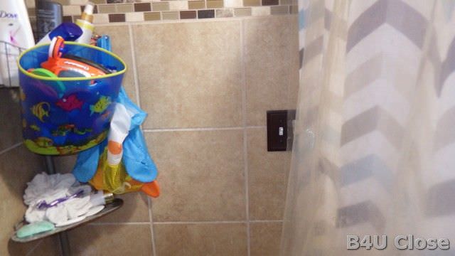

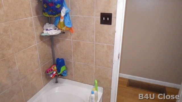

Erby Posted April 16, 2016 Report Share Posted April 16, 2016 The tub or the switch. Beats the hell outta me but one of them should be moved. Even the closed shower curtain didn't fully cover the switch. Click to Enlarge 34.84 KB Click to Enlarge 32.23 KB Link to comment Share on other sites More sharing options...
plummen Posted April 16, 2016 Report Share Posted April 16, 2016 Id say it would be easier to move the switch myself. Ive seen stupider things. Link to comment Share on other sites More sharing options...
John Kogel Posted April 16, 2016 Report Share Posted April 16, 2016 Shocking! [:-magnify In Canada the switch must be 3 feet away from the edge of the tub. In that situation with the tub by the door, we put the switches out in the hall. It seems inconvenient but people just get used to it. Link to comment Share on other sites More sharing options...
