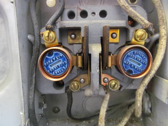

Rob Amaral Posted April 5, 2016 Report Share Posted April 5, 2016 more 'fun stuff' you never see anymore.. Outside Boston... 1931 house... former oil-burner fused-neutral emergency shut-off switch.. (hot).. Download Attachment: IMG_6588.JPG 67.28 KB Link to comment Share on other sites More sharing options...
kurt Posted April 5, 2016 Report Share Posted April 5, 2016 It says "Not A Fuse" on the blue thing. I don't understand. Beautiful though... Link to comment Share on other sites More sharing options...
John Kogel Posted April 5, 2016 Report Share Posted April 5, 2016 Right, they could be slugs, so there would be no fused neutral. Or WAG - Those could be breakers with reset button in that hole, made by Bryant. Link to comment Share on other sites More sharing options...
kurt Posted April 5, 2016 Report Share Posted April 5, 2016 I don't know. Maybe. They're cool looking though. You did try to steal them, didn't you? Link to comment Share on other sites More sharing options...
Rob Amaral Posted April 6, 2016 Author Report Share Posted April 6, 2016 I explained that the switch was a 'fused-neutral' switch but 'devices' have been put in place of the fuses that eliminate the 'fusing' aspect.. I told them to change the switch out because there are 'live parts' in this box when you open it.. Those are cool looking little guys though... aren't they? Link to comment Share on other sites More sharing options...
