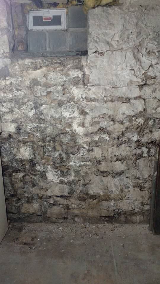

Hey all. Long story short I have discovered by an air quality test a mold issue in my basement. Pretty much the basement is going to be gutted. I am worried about the foundation work they are going to do. I have a stone foundation with crumbly, brittle, sandy layer on the interior wall. Apparently this is normal? Apparently this inside layer was applied to hold the mortar between the stones in place? Not exactly sure but the company is going to be scrapping the foundation walls and im sure get all the sandy, crumbling material off. Then they are going to apply antimicrobial coating, etc for the mold issue. Do I have to tell them certain techniques with a stone foundation or do the stones need re-appointing or mortar mix added or anything? Just don't want to have a foundation structure issue in the long run. here is a pic or two to show what the walls look like currently before the job gets underway. Thanks for the insight on my foundation! I need all the info I can get!!
Click to Enlarge
93.4 KB

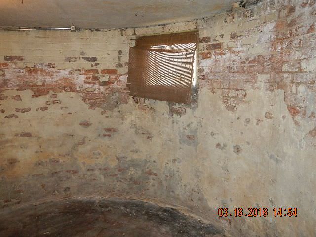

A disagreement on that one.....
Parging does next to nothing to reduce moisture migration through the wall; plugging a leak from the inside is backwards and the usual cement used for "parging" is absorbent and conducts moisture quite nicely. We know moisture moves through cement like thin shit through a tall Swede. If cement didn't conduct moisture, there wouldn't be any need for damp proofing foundations, drainage plane mats, or any other moisture proofing of foundations. The simple presence of entire industries devoted to keeping moisture from migrating through concrete should be proof enough that cement isn't waterproof.
There are a lot of ways for correcting and controlling moisture migration through old stone foundations, but parging definitely isn't one of them. The term parging, like tuckpointing, has been bastardized to mean smearing any kind of cement on any kind of masonry.
Parging was originally a high lime content mortar that acted more as a poultice for "nourishing" the old masonry than as a moisture barrier. The lime acted somewhat as a moisture barrier.....he miracle of lime and carbonatation (not carbonization, that's for fizzy drinks), slowed moisture migration, but it didn't prevent moisture moving into the foundation. Time and ignorance eventually eliminated lime and folks imagined there was some kind of magic to new mortars that kept out water. I don't know why they thought this. No one ever used to think this.
For reasons I do not understand, engineers like modern mortars. Modern mortars, applied to old stone foundations, have little use other than keeping the old sandy mortars from sifting out of the walls and to stabilize the foundation. That's about it. Moisture reduction....nope. They make people feel good though because it's all nice and clean looking.
Today's parged stone foundation.....pretty wet, but with lots of pretty new cement smeared all over it......

The picture in the OP looks like most of the thousands of stone foundations I've seen although several hundred look worse. It's completely normal. http://historicbldgs.com/stonefoundations.htm
Most of my clients get it but some folks just aren't the right type to live in and maintain an old house. These are the ones that call in a panic asking me to rush over and see their "crumbling foundation", when it's only some random flaking of the coating.
I'm starting to just ignore people that only want us to confirm their fear of mold is valid. I don't have patience to unbrainwash homeowners or even discuss it anymore with inspectors that fall for the crap spewed at the mold-is-gold seminars.

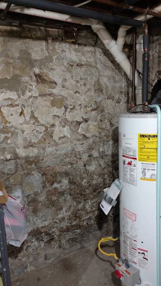

That was only once picture. here is another of black colonizing mold near the bottom left. its not the "crumbling foundation" that's an issue I realize after many, many years the mortared joints erode due to freeze/thaw and moisture seeping through. The crumbling spall I understand is normal. What's not normal is when you take a piece of grit off and almost pass out from the moldy odor. What's also not normal is black mold showing up on the crumbly walls. if mold growth like that is normal, and you've seen hundreds worse, then man that's scary after what the CDC says about side affects of mold.
I would also never be able to sell my property with the walls looking that crumbly and decayed and with black residue and mold on it. Its not uncommon for the walls to be "maintained" and cleaned up and repointed if needed. I don't see how that could be a bad thing, especially if it helps the mold issue and air quality throughout the whole house. So this is more then just normal random flaking it appears.

I can't really disagree with you other than to say that basements where the parging is in good condition (not from lack of deterioration, but from replacement) almost always seem to be far less damp.
Also, quite a bit of deterioration of parging usually does not bother me too much, but when the sand/lime mortar starts to pile up on the floor these walls can end up with structural problems that are expensive to fix.
Posted
They do seem dryer; I'll grant you that. That is, until it peels off and you see what's really going on under there.
They're damp. Almost all of them.
We have some around here where the soils are sand, like pure silica sand dune sand, remnants of the Ice Age glacier. Those guys are just fine and dandy. Dry as a bone.
Then, there's others built in areas that are filled in swampland and a city built on it. Those boys are a mess, and all one can do is slather them to keep the sandy mortar from sifting out.
No one size fits all with stone foundations. But, most of them are damp.
