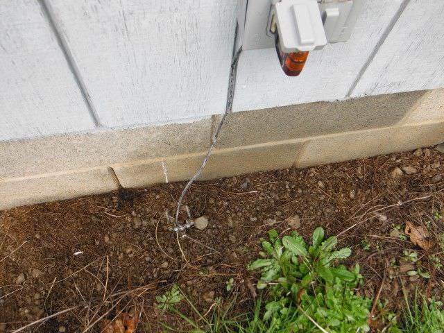

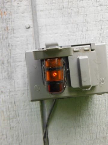

Denray Posted March 11, 2016 Report Share Posted March 11, 2016 Today's grounded outlet. Click to Enlarge 23.26 KB Click to Enlarge 82.29 KB Link to comment Share on other sites More sharing options...
Marc Posted March 11, 2016 Report Share Posted March 11, 2016 Ya know, there's electric currents in the earth and that means all points of the surface are not necessarily at the same potential. Meaning that unless that ground rod is bonded to the one connected to the main panel enclosure, it could be at a different potential. Marc Link to comment Share on other sites More sharing options...
John Kogel Posted March 11, 2016 Report Share Posted March 11, 2016 We see a grounding conductor from the rod to a hole in the wall that is shared with an outdoor outlet. The ground wire hopefully goes up to the breaker panel, not to that outlet. Link to comment Share on other sites More sharing options...
Denray Posted March 11, 2016 Author Report Share Posted March 11, 2016 To the outlet. They dun grounded it. Link to comment Share on other sites More sharing options...
