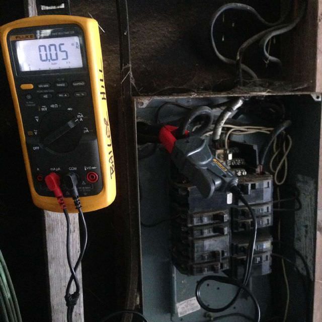

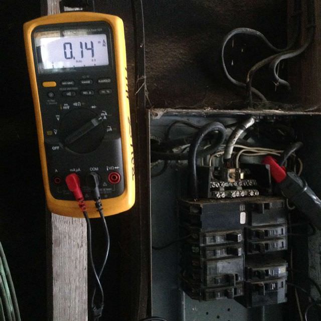

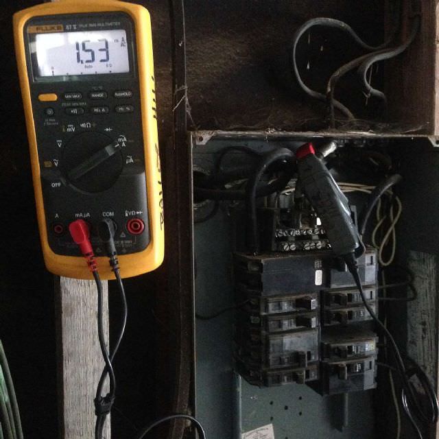

David Meiland Posted March 2, 2016 Report Share Posted March 2, 2016 I was at a house this morning where the complaint is high electrical usage. I ended up finding amp readings in a small panel that I don't understand. In the photos, the neutral wire shows about 1.5 amps on it, with the A and B phases showing almost nothing. There are a couple of 120 breakers in the panel for garage lights, and another for a well pump, which was not running. Nothing at all drawing on this panel as far as I could tell. I'm wondering if there is somehow an electrical "leak" going on here, because I'm accustomed to seeing a more logical relationship between these three readings. For instance, in my shop right now, there is 5 amps on the A phase, .9 amps on the B phase, and 4.1 on the neutral. The panel in the photos is in the garage. The service is overhead and comes down the exterior wall of the garage directly behind this panel. The meter, a large disconnect, and a trough are mounted on the exterior wall. There is a conduit going to the house carrying a 400-amp service to a pair of panels there. Not sure if it matters, but there are *big* conductors on the exterior, very close to where my amp clamp is. I normally don't think this will influence the reading at all. No doubt some of you guys can clear this up for me. Thanks in advance. Click to Enlarge 66.05 KB Click to Enlarge 63.67 KB Click to Enlarge 63.11 KB Link to comment Share on other sites More sharing options...
Marc Posted March 2, 2016 Report Share Posted March 2, 2016 The neutral conductor is carrying the difference between the 'A' leg and the 'B' leg. That's normal. When they are the same, they cancel out perfectly and the neutral current is zero. There's an exception to that rule that involves power factor values that are less than one but that's not a major player in this picture. I don't see anything wrong with those amps. Marc Link to comment Share on other sites More sharing options...
John Kogel Posted March 2, 2016 Report Share Posted March 2, 2016 Hey, Marc, the neutral is carrying 10 times the current shown on the hot wires. David, you may have some kind of a backfeed from the other panels finding a path to ground through that neutral you measured. Even so, those readings are not where the power loss is. But that may be a clue to the problem. Link to comment Share on other sites More sharing options...
Tom Raymond Posted March 2, 2016 Report Share Posted March 2, 2016 Check for open neutrals. I think John is on the right path with backfeed to ground. When I was a kid we had a high usage condition at my mom's house. After a while we would get zapped on appliances and the kitchen sink would arc when the water was turned on. The neutral on the three wire overhead was contacting a lightning rod. It resolved itself when the arc finally cut through the neutral. Link to comment Share on other sites More sharing options...

plummen Posted March 6, 2016 Report Share Posted March 6, 2016 Turn off the main and check the reading again,To make sure its not a a phantom reading. Link to comment Share on other sites More sharing options...
