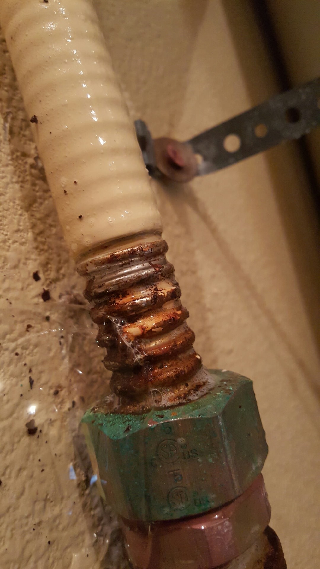

Brandon Whitmore Posted February 18, 2016 Report Share Posted February 18, 2016 We've been seeing more and more CSST leaks due to corrosion. Not to mention finding lots of leaks from nail penetrations, crappy installations, etc. Here's one from today. Click to Enlarge 78.37 KB Download Attachment: 20160217_151030.jpg 415.42 KB Link to comment Share on other sites More sharing options...
Jim Katen Posted February 18, 2016 Report Share Posted February 18, 2016 What's causing the corrosion? Would it help if the jacket were left intact right up to the fitting? Link to comment Share on other sites More sharing options...
Brandon Whitmore Posted February 18, 2016 Author Report Share Posted February 18, 2016 What's causing the corrosion? This was in a pool house. There was a piece of plumbers tape securing the CSST to the wall at the rusted area (dissimilar metal issue along with chemicals/corrosive environment?). I believe that leaving the jacket in place and taping the exposed steel would help, but this is just a hunch. Link to comment Share on other sites More sharing options...
