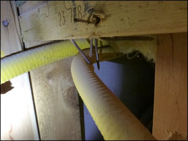

When it comes to CSST, improper support and protection is also a big concern, especially when it's installed in existing structures. Many times they cut a hole in finished basement ceilings at each end of a planned run and pull the pipe through. Now the pipe is in the cavity sometimes laying against surfaces where someone could later drive fasteners into it. I have s picture from a recent inspection. I'll post it when I get home this evening.

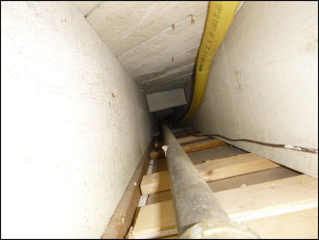

Posted
Here's a framing nail nearly puncturing CSST
Click to Enlarge

Here's a long run through a joist bay nudging the floor planks. It does not have proper support at correct intervals. If someone does renovations including building or moving walls above, this pipe is in a position to get damaged from driven fasteners.
Click to Enlarge
