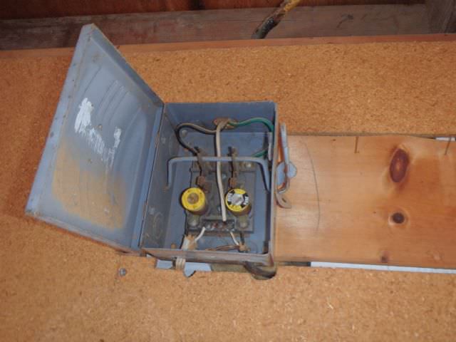

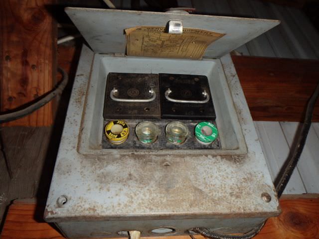

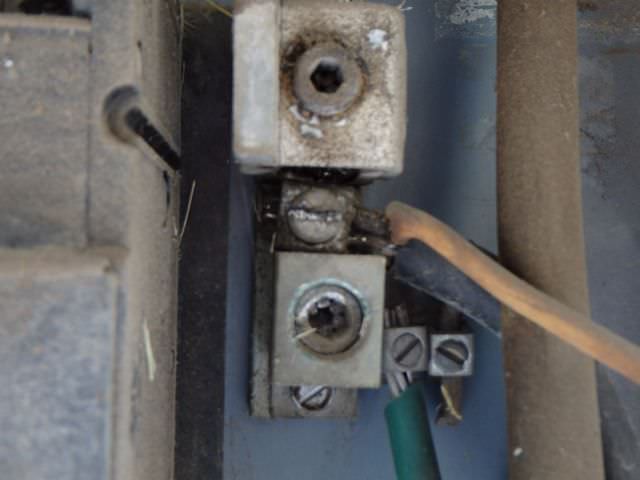

Inspector1 Posted January 9, 2016 Report Share Posted January 9, 2016 Check out the old screw-in fuses on this Trailer inspection. The double tap in the center for the outdoor panel on the center bar looks like it needs a qualified electrician to evaluate and replace. Concern type Safety Poses a safety hazard Click to Enlarge 44.43 KB Click to Enlarge 50.11 KB Click to Enlarge 45.87 KB Click to Enlarge 36.03 KB [:-thumbd][:-thumbd][:-thumbd] Link to comment Share on other sites More sharing options...
John Kogel Posted January 10, 2016 Report Share Posted January 10, 2016 No, it looks like it needs a qualified electrician to replace the hazardous installation. You have already evaluated it. Now tell them that it needs repair pronto before there is a fire or a shock. That looks like an extension cord feed from the main panel. The fuses appear to be over-sized for the wiring. It is all flaky junk. Even so, it is not a nightmare repair. A good electrician can have it all fixed in one afternoon. Link to comment Share on other sites More sharing options...
Jim Katen Posted January 10, 2016 Report Share Posted January 10, 2016 What's to evaluate? Those fuse panels have had it. They're obsolete and they've been miswired. The meter main wiring is dangerous and that cord has no business being wired into the panel at all, let alone like that. Instead of puddy-footing around, why not just tell the customer to hire an electrician to replace the fuse panels and spiff up the meter main? Give the customers some real information instead of leaving them wondering what the heck is going on. All this "evaluate" crap just rubs my fur the wrong way. Link to comment Share on other sites More sharing options...
Inspector1 Posted January 10, 2016 Author Report Share Posted January 10, 2016 I did tell the client that the whole panel and the pole that it was attached too needed to be replaced. The wiring going to the garage that had even more problems. The panel in the trailer had some double taps. It was all a HOT mess. [:-thumbd][:-thumbd][:-thumbd] Link to comment Share on other sites More sharing options...
Jim Katen Posted January 10, 2016 Report Share Posted January 10, 2016 I did tell the client that the whole panel and the pole that it was attached too needed to be replaced. The wiring going to the garage that had even more problems. The panel in the trailer had some double taps. It was all a HOT mess. [:-thumbd][:-thumbd][:-thumbd] Aside from what you told the customer orally, what did you actually write? Link to comment Share on other sites More sharing options...
Inspector1 Posted January 10, 2016 Author Report Share Posted January 10, 2016 The service conductor wires appeared to be rated for less amperage than other service components. This can result in the service conductor wires being overloaded. This is a potential fire hazard. Recommend that a qualified electrician repair/replace. I wrote the the service pole needed to be replaced. Link to comment Share on other sites More sharing options...
Erby Posted January 10, 2016 Report Share Posted January 10, 2016 I'm with you Jim. I've already evaluated. Have it fixed! Link to comment Share on other sites More sharing options...
