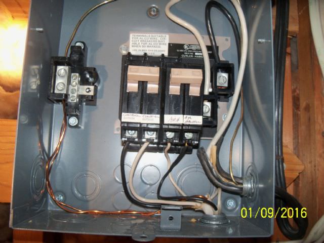

Darren Posted January 9, 2016 Report Share Posted January 9, 2016 Gentlemen, Does a sub panel need a four wire feed if the breakers are 2 pole? Thanks Click to Enlarge 54.48 KB Link to comment Share on other sites More sharing options...
Jim Katen Posted January 9, 2016 Report Share Posted January 9, 2016 If there are no 120-volt loads, then you don't need a neutral in the feeder. Is that terminal bar bonded to the panel enclosure? Link to comment Share on other sites More sharing options...
