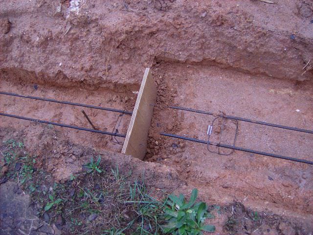

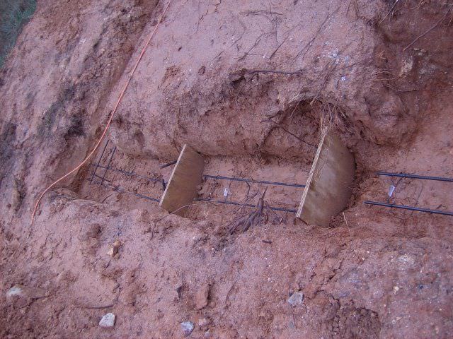

Jim Baird Posted November 4, 2015 Report Share Posted November 4, 2015 On the phone he seemed to get it. This is why we need inspectors. Click to Enlarge 97.01 KB Click to Enlarge 94.71 KB Click to Enlarge 92.51 KB Link to comment Share on other sites More sharing options...
Marc Posted November 4, 2015 Report Share Posted November 4, 2015 Maybe I'm in the midst of a senior moment but what's the problem? I don't see many of these stepped footings. Marc Link to comment Share on other sites More sharing options...
Jim Baird Posted November 4, 2015 Author Report Share Posted November 4, 2015 Stepped levels must bear minimum 8" on top of level below...so that bulkheads appear to "float" in the air. If they are tall enough that rebar turns down and joins that of the next level. Link to comment Share on other sites More sharing options...
David Meiland Posted November 5, 2015 Report Share Posted November 5, 2015 So, they're not forming the concrete at all, except where the steps are? Obviously they're going to need to move those pieces of plywood out over the level below, and somehow support them there so they don't blow out. I'd like to see photos if they actually do that. Link to comment Share on other sites More sharing options...
Jim Baird Posted November 5, 2015 Author Report Share Posted November 5, 2015 These are typical step bulkheads just put in the wrong position. One tall one will take more plywood and turned down rebar. Link to comment Share on other sites More sharing options...

Jim Baird Posted November 5, 2015 Author Report Share Posted November 5, 2015 The ditch is cut into such short pieces the bulkhead tops make grade. Otherwise most around here shoot in some little grade stakes at intervals that are pulled up post-pour. Link to comment Share on other sites More sharing options...
