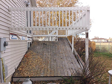

FrankWoeste Posted October 24, 2015 Report Share Posted October 24, 2015 "Researchers found that the loads from people can exceed those of the most severe earthquakes and hurricanes." http://www.djc.com/news/co/12077068.htm ... 1445724689 Link to comment Share on other sites More sharing options...
Erby Posted October 24, 2015 Report Share Posted October 24, 2015 Interesting! "On the other hand, when you fasten the boards at a 45-degree angle, the deck diaphragm is four times stiffer and six times stronger." Link to comment Share on other sites More sharing options...
Mike Lamb Posted October 25, 2015 Report Share Posted October 25, 2015 What I see as most informative is that newer composite decking floats on joists giving little lateral resistance. Good to look out for. Cross bracing joists from beneath would fix this. Link to comment Share on other sites More sharing options...

FrankWoeste Posted October 25, 2015 Author Report Share Posted October 25, 2015 What I see as most informative is that newer composite decking floats on joists giving little lateral resistance. Good to look out for. Cross bracing joists from beneath would fix this. From the Don Bender news story: "One fairly recent development in wood and WPC deckboards is "hidden fasteners" that fit in a slot on the side of each board. Great idea right? You don't see the fastener, and the slot allows the board to slip so that thermal expansion and shrinkage won't cause the boards to buckle. The problem is that since the fasteners allow slip, the deck diaphragm has almost no stiffness from side-to-side. This means that the deck substructure must provide nearly all of the resistance to lateral loads. This can result in a complicated design that should be performed by a registered design professional." Link to comment Share on other sites More sharing options...

Jim Katen Posted October 25, 2015 Report Share Posted October 25, 2015 What I see as most informative is that newer composite decking floats on joists giving little lateral resistance. Good to look out for. Cross bracing joists from beneath would fix this. To meet or exceed the lateral resistance of wood decking: How big should this cross bracing be? How many cross braces should be there? What sort of fasteners should be used and how many? Link to comment Share on other sites More sharing options...
Mike Lamb Posted October 25, 2015 Report Share Posted October 25, 2015 What I see as most informative is that newer composite decking floats on joists giving little lateral resistance. Good to look out for. Cross bracing joists from beneath would fix this. To meet or exceed the lateral resistance of wood decking: How big should this cross bracing be? How many cross braces should be there? What sort of fasteners should be used and how many? One cross brace. I might try a 2x10 diagonal from outside corner of deck to opposite ledger. 3 screws in each joist. 3" deck screws would do. A steel corner iron could do this, fastened right. Link to comment Share on other sites More sharing options...

Jim Katen Posted October 26, 2015 Report Share Posted October 26, 2015 What I see as most informative is that newer composite decking floats on joists giving little lateral resistance. Good to look out for. Cross bracing joists from beneath would fix this. To meet or exceed the lateral resistance of wood decking: How big should this cross bracing be? How many cross braces should be there? What sort of fasteners should be used and how many? One cross brace. I might try a 2x10 diagonal from outside corner of deck to opposite ledger. 3 screws in each joist. 3" deck screws would do. A steel corner iron could do this, fastened right. Hmm. Given a 12x12 deck with joists at 24" oc, and 2x6 decking, there would be about 336 3-inch screws holding traditional wood boards to the deck. Even if the boards are not running diagonally, that's a fair bit of lateral strength. (It would be greater if the boards were wider or if they were run diagonally, but it's still a lot of strength.) You're plan would replace that strength with 21 screws in a single board. What value are you using for the shear strength of the screws? Are you derating for wet conditions? Are you sure that your screws in that orientation are going to provide 16 times the strength of the screws in the original configuration? I only pose these questions because this stuff isn't as straightforward as it seems as first. It's easy for us to say, "just put a diagonal batten under the joists," but the details are often more complicated. Link to comment Share on other sites More sharing options...
mlparham Posted October 27, 2015 Report Share Posted October 27, 2015 What I see as most informative is that newer composite decking floats on joists giving little lateral resistance. Good to look out for. Cross bracing joists from beneath would fix this. To meet or exceed the lateral resistance of wood decking: How big should this cross bracing be? How many cross braces should be there? What sort of fasteners should be used and how many? One cross brace. I might try a 2x10 diagonal from outside corner of deck to opposite ledger. 3 screws in each joist. 3" deck screws would do. A steel corner iron could do this, fastened right. "Deck" screws are not rated for structural applications. Link to comment Share on other sites More sharing options...
mjr6550 Posted October 28, 2015 Report Share Posted October 28, 2015 It is not an easy question to answer because lateral loads on decks are not well understood. I think a worst case lateral load for a deck is about 12 psf. So with a 15x15 deck that would be 2700 pounds. Then try to figure out the stiffness of the decking and how the forces are transferred into the brace. Force is proportional to deflection, so as the deck sways a little the fasteners in the brace near the outside edge of the deck see more of the force. If the deck is high, then bracing the columns is also advisable, but the columns have to be large enough so they are not overloaded in bending. Link to comment Share on other sites More sharing options...
