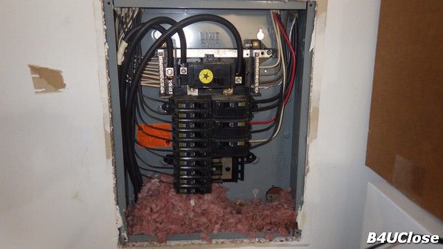

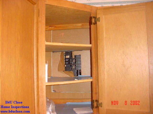

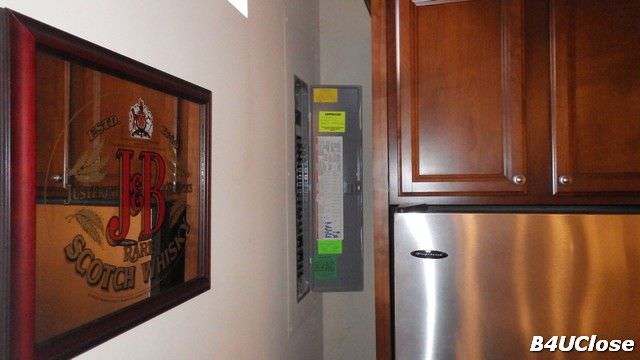

Erby Posted October 4, 2015 Report Share Posted October 4, 2015 Click to Enlarge 36.62 KB Ah, C'mon. You mean this isn't OK! [:-monkeyd[:-monkeyd[:-monkeyd Then you sure wouldn't like this one! Click to Enlarge 41.49 KB Or the ever present mouse nest! Click to Enlarge 38.04 KB Link to comment Share on other sites More sharing options...
