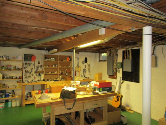

Steven Hockstein Posted September 5, 2015 Report Share Posted September 5, 2015 I thought I had seen almost everything. Something new this week. The added beam appears to be installed to reduce deflection in the floor of the dining room above. I like that the steel post is resting on the workbench. I can only assume that the workbench is included in the deal. Click to Enlarge 58.39 KB Link to comment Share on other sites More sharing options...
