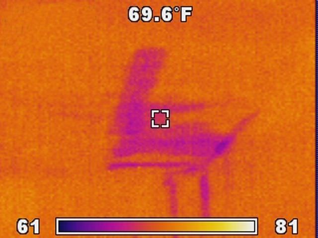

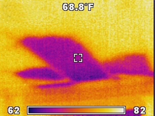

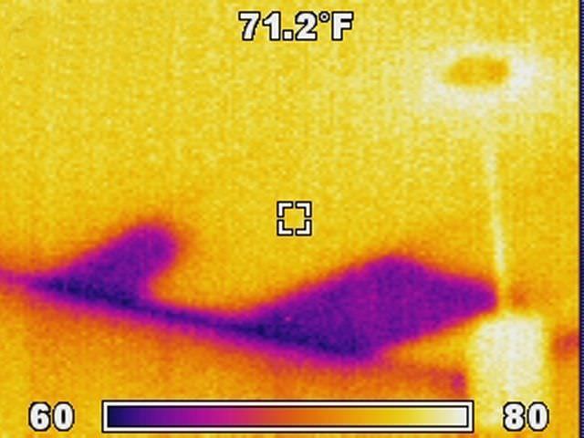

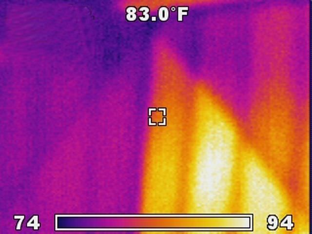

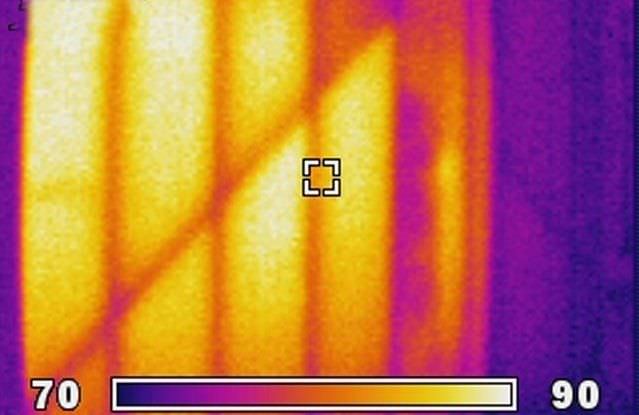

John Kogel Posted September 3, 2015 Report Share Posted September 3, 2015 You can use a hammer or you can use IR. These are some insulation pics I found in my files. Click to Enlarge 40.12 KB Click to Enlarge 47.56 KB Click to Enlarge 40.53 KB Click to Enlarge 37.22 KB Click to Enlarge 47.13 KB Link to comment Share on other sites More sharing options...

John Kogel Posted September 4, 2015 Report Share Posted September 4, 2015 Originally posted by John Kogel You can use a hammer or you can use IR. These are some insulation pics I found in my files. Very nice photos. Which one of the pics shows the difference between air infiltration or leakage. I can't say, not sure if i understand the question. There's an old house wall there where they blew in some insulation but hit diagonal bracing in the corners. Sunny side so the unsinsulated wall cavity is warmer. There's a couple of ceilings with insulation batts missing. Stuff like that. The one wall with cool spots? We couldn't get in there to see. Just an idle curiosity until somebody tears in there with the hammer. [] Link to comment Share on other sites More sharing options...
