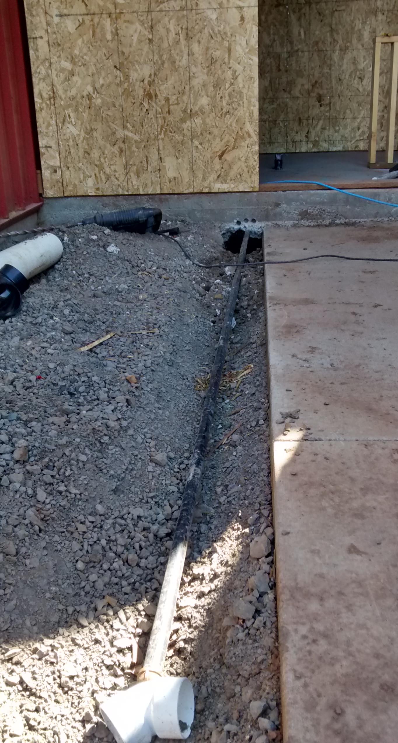

Brandon Whitmore Posted August 22, 2015 Report Share Posted August 22, 2015 Here's a poor picture from a gas line inspection I did last week. There are several violations visible, assuming you can zoom in to see good enough. I showed up to size our gas service and meter, and to do some consultation work. The owner asked me to check things out while the plumber was working away. Before I left, they asked me how to fix it (not just this one issue). After considering their options, they decided to start completely from scratch. Nothing like throwing appx. 10k down the drain. Download Attachment: gas1.jpg 1716.78?KB Link to comment Share on other sites More sharing options...
