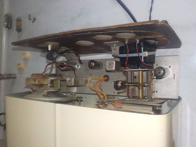

John Kogel Posted August 2, 2015 Report Share Posted August 2, 2015 My daughter moves around a lot, working with the Canadian Red Cross. She recently put in a request for a cool radio to personalize her new digs. I am super busy but have managed to make time for a fun project. The 1950 Westinghouse Risemaster clock radio is a good looking table radio and the Telechron clock is fairly accurate, not sluggish or noisy, which means I don't have to give it an oil change. I replaced all the waxed paper and foil capacitors, swapped out a weak tube and gave it an alignment. So it plays good now but who wants to hear AM radio? She will catch the CBC news with it and that's about it. These radios can be quite safe but can carry 120 volts on the chassis if something goes wrong. So I have installed this innovation. A 12 volt wall wart power supply has a step-down transformer in it to get 12 volts from 120. I cut open the case, remove the prongs, solder a stereo headphones jack to the secondary side and a shielded cord to the primary side, and tape the case back up. It is sitting there attached with a zap strap with som foam bumpers to hold it. The little transformer isolates the jack from the radio, which is important. We don't want the radio to bite the iPod, do we? The 1 to 10 boost is a bonus, because the iPod volume can be set low for low distortion. The radio provides the volume and decent tone, better than those tinny headphones, no doubt. Because she will leave the radio tuned to one station, I have installed a mute switch on a folded length of plumber's strap. It just cuts the signal from the front end of the radio at the volume control. I never drill or modify in any way that can't be undone, but this little mod makes the radio so much more enjoyable. Yes there is still a bit of a shock hazard from the radio if something malfunctions, but I have installed a polarized cord, new capacitors and the knobs are good. Click to Enlarge 44.42 KB Click to Enlarge 41.18 KB Here we are listening to Keith Relf, who died of electrocution in his basement in 1976. Sounds way better on the radio than he did on the laptop. [] Click to Enlarge 36.34 KB Link to comment Share on other sites More sharing options...
Marc Posted August 2, 2015 Report Share Posted August 2, 2015 I'm amazed it works, given that you used a 60 cycle power transformer instead of an audio transformer and on top of that, threw impedance matching to the wind. But hey, if it works.... Marc Link to comment Share on other sites More sharing options...

John Kogel Posted August 3, 2015 Author Report Share Posted August 3, 2015 I'm amazed it works, given that you used a 60 cycle power transformer instead of an audio transformer and on top of that, threw impedance matching to the wind. But hey, if it works.... Marc Audio schmodio. Audio frequencies in, audio frequencies out. Anyway 60 cycles is in the audible range, that's the bass, so maybe that's why it works. Impedance matching is 2 10K resistors to simulate the earbuds. But it works without them just as well, so who knows? Then left and right channels are just twisted together and soldered at the transformer. Here's another thing, Marc. The audio is digital, little stair step sound waves, but the grid of the tube converts it to analog. The little tubes just don't know any other way. [] Link to comment Share on other sites More sharing options...
