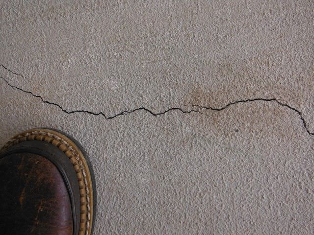

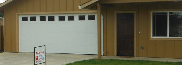

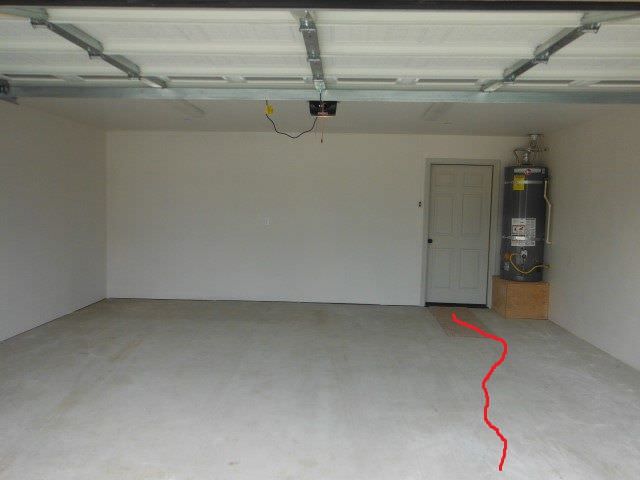

Denray Posted June 19, 2015 Report Share Posted June 19, 2015 This crack runs all the way across this 9-2014 built home garage floor. No displacement. Is it a problem? Click to Enlarge 31.05 KB Click to Enlarge 39.87 KB Click to Enlarge 91.25 KB Link to comment Share on other sites More sharing options...
kurt Posted June 19, 2015 Report Share Posted June 19, 2015 No. Link to comment Share on other sites More sharing options...
Marc Posted June 19, 2015 Report Share Posted June 19, 2015 No. The concrete is just curing, shrinking and cracking as it goes. The steel mesh embedded within it keeps the cracks narrow and on the level. Marc Link to comment Share on other sites More sharing options...

Nolan Kienitz Posted June 20, 2015 Report Share Posted June 20, 2015 See it all the time here in Texas. Typically not a concern. Link to comment Share on other sites More sharing options...
mlparham Posted June 20, 2015 Report Share Posted June 20, 2015 Concrete gets hard and cracks. As long as you cannot stick you pencil in the crack and there is no vertical displacement I would not worry about it. Link to comment Share on other sites More sharing options...
Jim Katen Posted June 20, 2015 Report Share Posted June 20, 2015 Thanks guys. Just seemed kind of big for a new house. My son did a big slab patio in his back yard a while back. He's an engineer. Put a bunch of rebar in it. No cracks, no cracks, no cracks, then I saw them starting the other day. So sad. Rebar and steel mesh do nothing to prevent cracks, although they can hold that cracked sections together. If you want to make a slab with no cracks, you've got to prepare an excellent sub base, use a very dry concrete mix with very little slump, and cure it carefully and slowly. I've done it and, after doing a few, I came to really like the look of cracks. . . Link to comment Share on other sites More sharing options...
ghentjr Posted June 21, 2015 Report Share Posted June 21, 2015 I bought my present home in 1978. It has a 1/4" crack in floor of a garage addition built in the early part of 1970. It extends full length and into the garage apron on the exterior. It has not moved, expanded, leaked, or otherwise caused any problems in all these years. It has filled itself with dust and dirt over the years. It has been on my Honeydo list and I will fill it when I get a "roundtuit". Link to comment Share on other sites More sharing options...
mjr6550 Posted June 22, 2015 Report Share Posted June 22, 2015 I agree that it is a typical shrinkage crack. You should not be surprised that the crack extend the full length of the slab. That is common for shrinkage cracks. Based on the location of the crack I am guessing that the slab continues under the wall at the right side of the garage and extends a significant distance. Link to comment Share on other sites More sharing options...

mjr6550 Posted June 23, 2015 Report Share Posted June 23, 2015 Photo Click to Enlarge 18.09 KB Rule of thumb for a slab is to install control joints if the ratio of the length to width exceeds 1.5/1. It is pretty common to see a crack across the slab if the ratio is about 2/1 or greater. Link to comment Share on other sites More sharing options...
kurt Posted June 23, 2015 Report Share Posted June 23, 2015 Ratios sound good, but don't mean much without a spec on the mix. We do about 8' centers; those at least crack in the control joints. Link to comment Share on other sites More sharing options...
