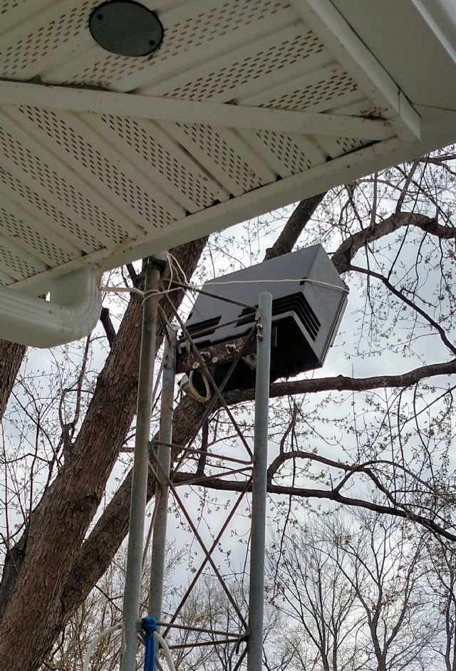

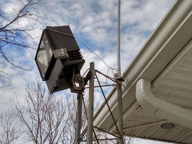

Mike Lamb Posted June 1, 2015 Report Share Posted June 1, 2015 What NEC code violations do you see in these photos? Thanks. Click to Enlarge 71.86 KB Click to Enlarge 177.01 KB Link to comment Share on other sites More sharing options...
Mike Lamb Posted June 2, 2015 Author Report Share Posted June 2, 2015 Do the wires need to be protected coming through the aluminum soffit? Link to comment Share on other sites More sharing options...
Jim Katen Posted June 2, 2015 Report Share Posted June 2, 2015 If that's NM cable, it's not allowed to be used at all in a location where it will get wet or be exposed to UV light. Link to comment Share on other sites More sharing options...
Leighton Jantz Posted June 2, 2015 Report Share Posted June 2, 2015 I like the giant twist tie preventing the light housing from falling forward. Link to comment Share on other sites More sharing options...
Jim Baird Posted June 3, 2015 Report Share Posted June 3, 2015 ...they could have brought the wire out of that box in some flexi conduit. Link to comment Share on other sites More sharing options...
Mike Lamb Posted June 3, 2015 Author Report Share Posted June 3, 2015 A friend sent the photos and asked if I saw code violations. She is very upset a neighbor put this up and it now glares into her house at night. Link to comment Share on other sites More sharing options...
