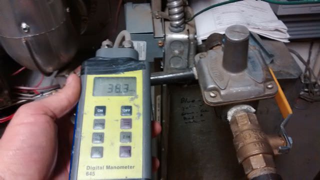

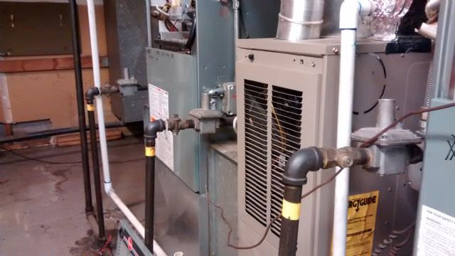

Brandon Whitmore Posted May 6, 2015 Report Share Posted May 6, 2015 2 psi systems for natural gas are becoming more common by the day, so I thought this might help someone...... I inspect these systems daily, and it seems like only about half are properly plumbed. Some installations are downright dangerous. There's 2psi inlet pressure to these Maxitrol regulators. Can you spot the defects.... Click to Enlarge 42 KB Click to Enlarge 25.8 KB Link to comment Share on other sites More sharing options...
inspector57 Posted May 6, 2015 Report Share Posted May 6, 2015 I count 6 defective items, two on each furnace. Link to comment Share on other sites More sharing options...
Brandon Whitmore Posted May 6, 2015 Author Report Share Posted May 6, 2015 Jim, If you're counting defects per furnace, there's quite a few more. [] I'll give it a while before spilling what I see. Let's just say it wasn't safe enough to leave the gas meter turned on; the customer was far from happy with me. This 2psi system has been installed for over 20 years, and was approved by the AHJ. The defects were missed by the "home" inspector a year ago, and missed by several HVAC contractors who have had service contracts here. Link to comment Share on other sites More sharing options...

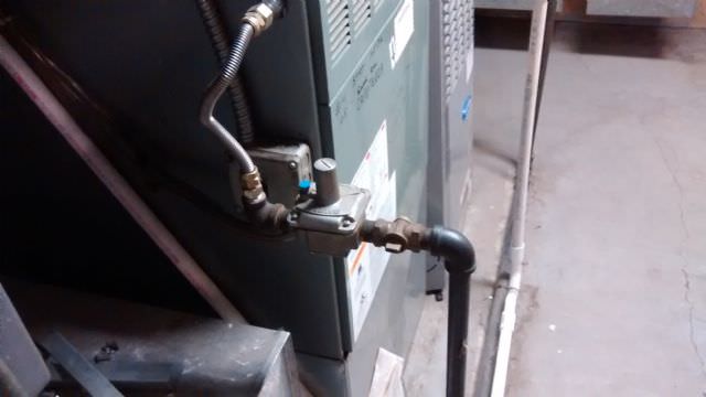

Brandon Whitmore Posted May 6, 2015 Author Report Share Posted May 6, 2015 This picture should help. Click to Enlarge 34.18 KB Link to comment Share on other sites More sharing options...

Brandon Whitmore Posted May 6, 2015 Author Report Share Posted May 6, 2015 Gas piping/ regulator issues I wrote up, that are visible in these pictures.... 1) MP regulators have round bodies, while RV regulators are square. This is the easiest way to recognize that there's a problem. MP regulators are supposed to be used to drop pressure from pounds of pressure to inches (27.67" w.c. = 1 psi) The codes require lock up type regulators for 2psi systems...RV regulators do not lock up- they slowly build. The last picture shows pressure above 14" w.c. (max. for low pressure systems) Within a few minutes, pressure on the regulators shown in the above pictures built from 8" all the way to about 46" w.c.) Standard pressure (low pressure) systems do not require MP regulators-- regulators are typically built into equipment combination valves nowadays. If you look at these combination valves, you will see that with natural gas, they typically call for a range of inlet pressure from say 3.5" to 10" w.c. You will also see where they are listed/labeled/ tested for a max. 1/2 psi (read a combination valve on a furnace or water heater if curious). Over pressurizing the appliance combination valves in this case most likely voids any manufacturers warranty, violates the listing, etc. What's interesting is the combination of issues that develop. Anything from having equipment running way over or under fired, to appliance regulators locking up, to pressures pulsing (inshot burner flames pulsating) I saw all of this @ the job above-- there were 14 pieces of equipment, all of which were installed the same way. Link to comment Share on other sites More sharing options...
Brandon Whitmore Posted May 6, 2015 Author Report Share Posted May 6, 2015 The improper regulators were one of the reasons I shut gas off to the equipment at this place. The other issue was that there were a bunch of gas leaks throughout the piping system. Other minor issues: 1)These particular brass line valves are not approved for 2 psi gas systems. 2)The required sediment traps, which also function as the pressure taps are missing. 3)The required pressure taps at the downstream / low pressure side of the regulators were missing as well. This was a non- issue for the ones plumbed in with flex connectors, but was an issue with others hard piped with unions. A properly plumbed 2 psi system should have the following, in order from 2 psi piping downstream to the equipment: 1)A line valve. 2)A sediment trap/ pressure tap. 3)The MP regulator. 4)A pressure tap. Link to comment Share on other sites More sharing options...
