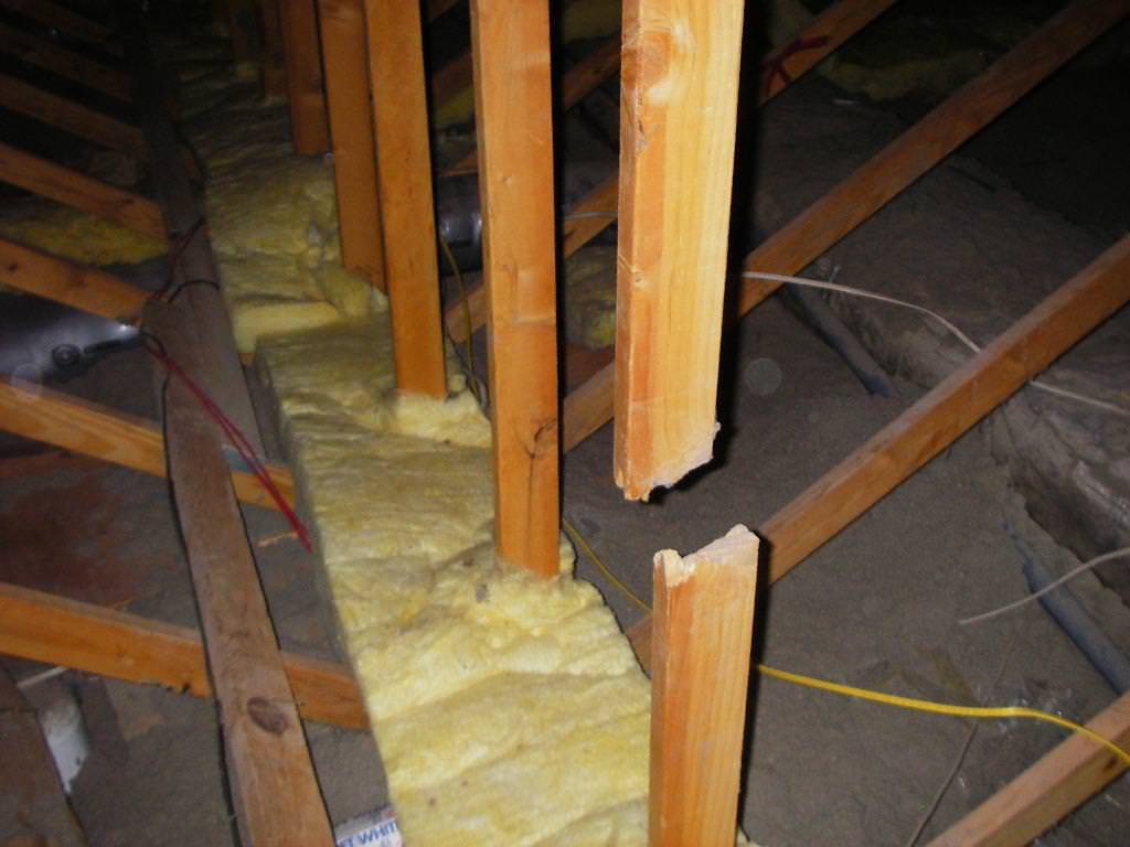

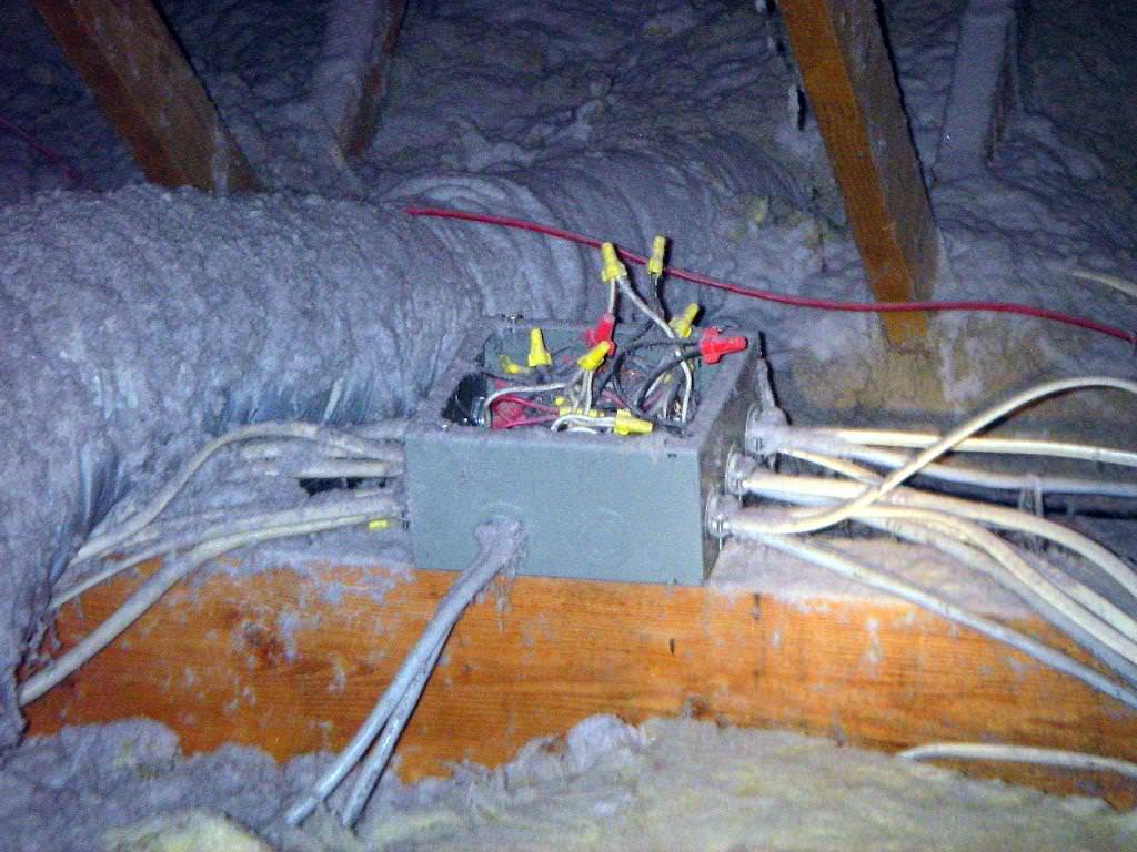

homnspector Posted November 23, 2005 Report Share Posted November 23, 2005 We haven't had any pithy topics lately, so I thought I might share some photos from the attic of an Adult Care facility I inspected this week. Dryer and range vent terminate in the attic, a furnace is installed in the attic. I counted about a dozen J boxes without covers and some splices w/o J boxes. All furnace and fireplace vents are covered with lint and grease and most with improper clearances. It is a firetrap with about 8 elderly residents who might not make it out. I HOPE the report will force some upgrades. If not, I think I need to report it to somebody but am not sure of the legal ramifications of such a disclosure to whoever the proper authorities are. Needless to say, the problems were not confined to the attic. Download Attachment: IMGP1201.JPG 161.78 KB Download Attachment: IMGP1205.JPG 122.79 KB Download Attachment: IMGP1209.JPG 85.45 KB Download Attachment: IMGP1213.JPG 111.69 KB Download Attachment: IMGP1216.JPG 147.51 KB Download Attachment: IMGP1225.JPG 138.47 KB Download Attachment: IMGP1237.JPG 128.64 KB Link to comment Share on other sites More sharing options...

Scottpat Posted November 24, 2005 Report Share Posted November 24, 2005 I'm afraid I would have to send a little note the the local fire marshal. That is a fire trap. Link to comment Share on other sites More sharing options...
