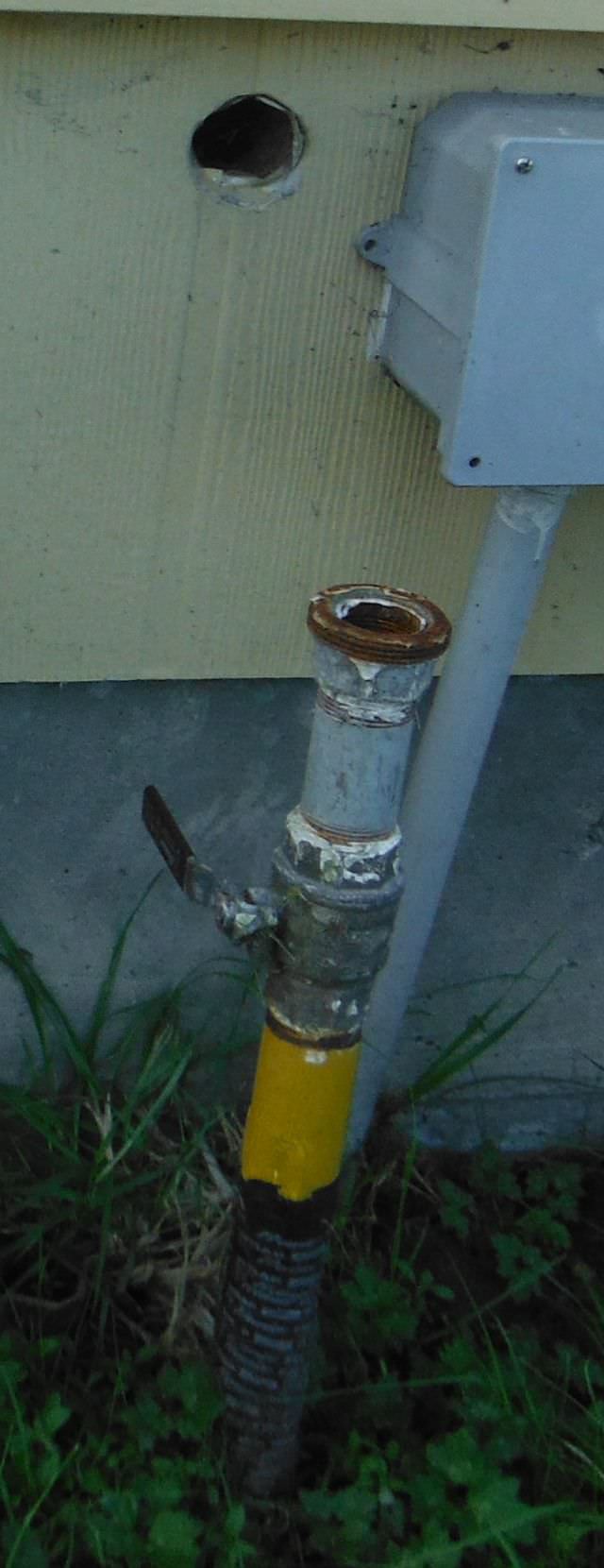

Denray Posted April 13, 2015 Report Posted April 13, 2015 What was this for on this 7 year old house that is no longer in use? Click to Enlarge 124.47 KB
Denray Posted April 14, 2015 Author Report Posted April 14, 2015 Could there be a buried tank there? Click to Enlarge 44.1 KB
Chad Fabry Posted April 14, 2015 Report Posted April 14, 2015 It's almost certainly from an abandoned gas line. What did it smell like when you opened the valve?
Bill Kibbel Posted April 14, 2015 Report Posted April 14, 2015 There used to be a gas pipe feeding out, probably to a generator.
Denray Posted April 14, 2015 Author Report Posted April 14, 2015 I spoke with the owner. Says that's were gas service used to come in at. Thanks for the help guys!
Marc Posted April 14, 2015 Report Posted April 14, 2015 That explains the transfer switch. Probably a pad-mounted standby generator. Marc
Brandon Whitmore Posted April 14, 2015 Report Posted April 14, 2015 That service riser and meter look pretty old to me-- are they really only 7 years old?
