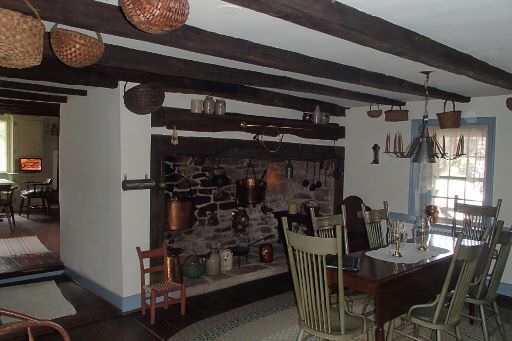

I saw the first fireplace at a structural inspection yesterday. The day before I inspected a house built in 1967 that was supposed to be a modern interpretation of a historic Chester County stone farmhouse. The other photos are the modern version of the first fireplace.

That's a lot of weight on that cantilevered beam.
If my eyes aren't deceiving me, the upper beam is spalled at a critical point.

Its a timber lintel. It just uneven and the plaster was filled in around the edges.

...More than once I have seen modern faux fireplace work that creates such a looming sensation of massive masonry overhead that I want to cringe in the behemoth's presence.
If you look at the right side of the modern fireplace you will see a steel column. The right side of the fireplace is lower than the left side. Apparently the column was added later. At the left side a stone wall projects about 6 feet past the exterior wall. At the right side the stone only projects about 3 feet. I believe that there was not enough weight at the right side to counterbalance the cantilevered stone.

Not talking about the lintel.

A beam and a lintel are the same thing. A horizontal load bearing member.

There was some honeycombing in the lintel?/cantilevered beam? I don't recall it looking that dark. I looked at a higher resolution photo. It is not spalling and I don't think it is a concern.

Lintel is a more precise term to describe a beam used to support masonry.
That's what I thought. Lintels support masonry, beams support any number of things. lentils go in soup or curry.
