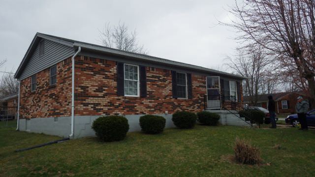

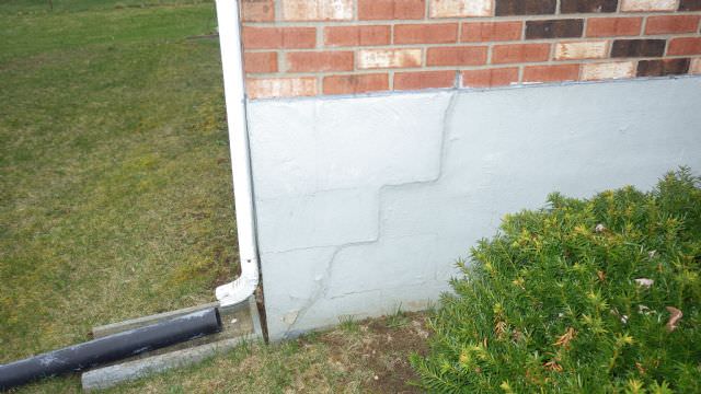

ductwork Posted March 28, 2015 Report Posted March 28, 2015 Had an inspection today, house was brick veneer, step crack 1/2 wide at points with no displacement, on the interior, no evidence of any cracking in the drywall or baseboards, I am not one to call out a structural engineer since this is brick veneer, no evidence on the corresponding interior location. Click to Enlarge 78.83 KB
Marc Posted March 28, 2015 Report Posted March 28, 2015 That's not a step crack. It's a vertical crack that's staggered a little. Was that the only one on the house? Marc
ductwork Posted March 28, 2015 Author Report Posted March 28, 2015 There was a small one near the front, I am not concerned about that one, this is the only one that stood out, this one is on the side of the home.
Tom Raymond Posted March 28, 2015 Report Posted March 28, 2015 How long was the wall? Looks like an expansion crack to me.
Jerry Simon Posted March 28, 2015 Report Posted March 28, 2015 That void has widened/moved after it was (at least once) patched; pretty obvious from the picture. I would tell a client that if the wall continued to move - and only time will tell if it will - costs to stabilize the wall & perhaps the (moving?) foundation wall below could be significant. Or, like Tom said, could just be an on-going expansion crack.
ductwork Posted March 29, 2015 Author Report Posted March 29, 2015 The crack extends down to the crawl space entrance door, it is approximately 3 feet in length , the crack is not visible from within the crawlspace area, the safe way out would be to just recommend a structural engineer however I do not want to sound the alarms .

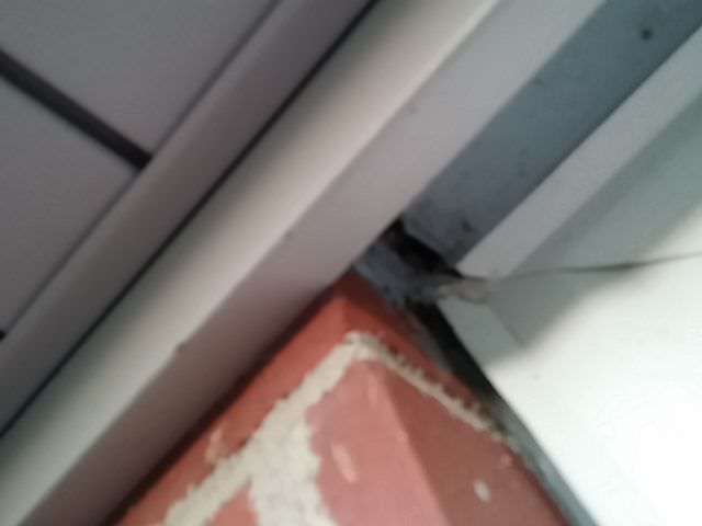

ductwork Posted March 29, 2015 Author Report Posted March 29, 2015 No I do not, I will advise the client to seek further evaluation . The steel lentil on the opposite side has cracked/shifted, the lentil on the side with the crack has cracked Click to Enlarge 21.75 KB

Tom Raymond Posted March 29, 2015 Report Posted March 29, 2015 No I do not, I will advise the client to seek further evaluation . The steel lentil on the opposite side has cracked/shifted, the lentil on the side with the crack has cracked Click to Enlarge 21.75 KB There is no lintel there. That is the soffit, or a piece of wood trim, covered in aluminum coil. A lintel supports masonry over an opening.
mjr6550 Posted March 29, 2015 Report Posted March 29, 2015 I think Tom is correct, assuming the wall is relatively long. Thermal expansion in long brick walls can cause cracks like that. Here are a couple photos I took last month at a wall in a row of about 10 townhouses with no control joints. Click to Enlarge 46.46 KB Click to Enlarge 51.38 KB
ductwork Posted March 29, 2015 Author Report Posted March 29, 2015 No I do not, I will advise the client to seek further evaluation . The steel lentil on the opposite side has cracked/shifted, the lentil on the side with the crack has cracked Click to Enlarge 21.75 KB There is no lintel there. That is the soffit, or a piece of wood trim, covered in aluminum coil. A lintel supports masonry over an opening. It was a steel lintel, it was not the soffit or a piece of wood trim covered in aluminum, I did feel the material and it was definitely steel .

Ben H Posted March 29, 2015 Report Posted March 29, 2015 No I do not, I will advise the client to seek further evaluation . The steel lentil on the opposite side has cracked/shifted, the lentil on the side with the crack has cracked Click to Enlarge 21.75 KB There is no lintel there. That is the soffit, or a piece of wood trim, covered in aluminum coil. A lintel supports masonry over an opening. It was a steel lintel, it was not the soffit or a piece of wood trim covered in aluminum, I did feel the material and it was definitely steel . Sure looks like a soffit and a freeze board to me.
