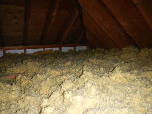

Look at the insulation. Kinda bumpy and uneven in a pattern very familiar to me. What's it mean to you folks?
I have a disagreement with a service vendor about what it means.

Looks like it was compacted and then re-lofted. Is the disagreement over whether he actually blew in new insulation or not?

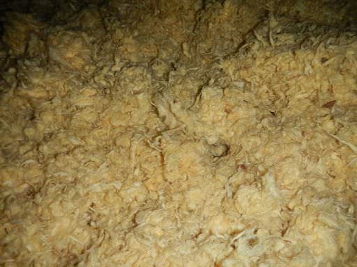

Whoops, I'd only looked at the first photo when I responded with the line above. After seeing the second picture with what looks like a finger-sized hole in the insulation I'd have to say mice. Bigger holes with lot of crap - rats - but that's not what I'm seeing there.

Yeah. Exactly. Rodents. I was pointing out all these trails and burrows, and the pest guy was saying that's normal and it isn't rodents. I had to double check to see if I was nuts.

Rats. Mice are more discreet. But maybe they've had both at different times. [:)]
I am amazed at how ignorant some pest control guys are. At least from the comments they make to my clients, some of them are truly clueless.

Let me see if I can figure out why a pest guy would say those aren't rodent burrows. Perhaps the pest guy got paid to eliminate the rodents and now he's not willing to admit that he might not have done such a hot job?
