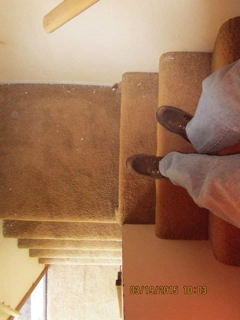

Les Posted March 19, 2015 Report Share Posted March 19, 2015 I generally don't like to read about issues we all see every day. This was an exception. I was asked to dispute the inspector's finding that this is unsafe. Not! Click to Enlarge 39.33 KB Click to Enlarge 50.42 KB Link to comment Share on other sites More sharing options...

StevenT Posted March 19, 2015 Report Share Posted March 19, 2015 It sure is steep! Looks like a staircase going to an attic. If that's the case, I would rather have this than a pull down ladder. Now if they are bedrooms up there and they are included in the bedroom count, I have a problem with it. Actually, I reconstructed a home that has a really large attic, rather than a pull down ladder, the only staircase I could fit is also quite steep. Mine even has a dormer that you can hit your head if you don't duck. Having said that, both of my sons use this area, it is great for storage, and if I ever decide to sell; I would never include the 2 rooms in the bedroom count. In my head, I would rather have the stairs than a ladder, but agree it should be included in the report. Link to comment Share on other sites More sharing options...

Les Posted March 19, 2015 Author Report Share Posted March 19, 2015 Three bedrooms and a bath up there! The treads were all different sizes; use my size 8 boot for reference. They were bitching about the inspector writing this as an access/egress issue. including smoke alarms, carbon monoxide, open end handrail, carpet, pitch, hole in wall, etc. Link to comment Share on other sites More sharing options...

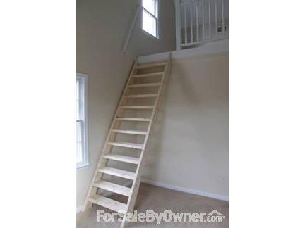

hausdok Posted March 20, 2015 Report Share Posted March 20, 2015 Ships ladder, See 'em occasionally for attics, lofts in A-frames, access for kids to little built-in play rooms. Those things are not fat guy friendly, let me tell you. One slip and you go bouncy, bouncy, bouncy all the way down dragging your hands over your head on the handrails. Don't ask me how I know - it was humiliating. Did you pay them when you told them what they did not want to hear? ONE TEAM - ONE FIGHT!!! Mike Link to comment Share on other sites More sharing options...

Les Posted March 20, 2015 Author Report Share Posted March 20, 2015 It passed the "FHA" appraiser inspection. They paid me. Inspector thanked me. Agent continues to hate me. Seller is sure I am a fool. Bank lost another govt loan. POTENTIAL BUYER is informed and happy! That is all that matters. Link to comment Share on other sites More sharing options...

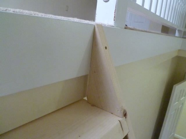

Welmoed Posted March 21, 2015 Report Share Posted March 21, 2015 I did a house with a ship's ladder into a loft space. Got to the top and discovered that the only thing holding the ladder up was two drywall screws, one on each stringer. Yeah, I went back down VERY carefully. Click to Enlarge 11.68 KB Click to Enlarge 24.3 KB Link to comment Share on other sites More sharing options...

palmettoinspect Posted March 22, 2015 Report Share Posted March 22, 2015 It looks like in the first picture someone's head has already meet the wall at the landing lol! Link to comment Share on other sites More sharing options...
