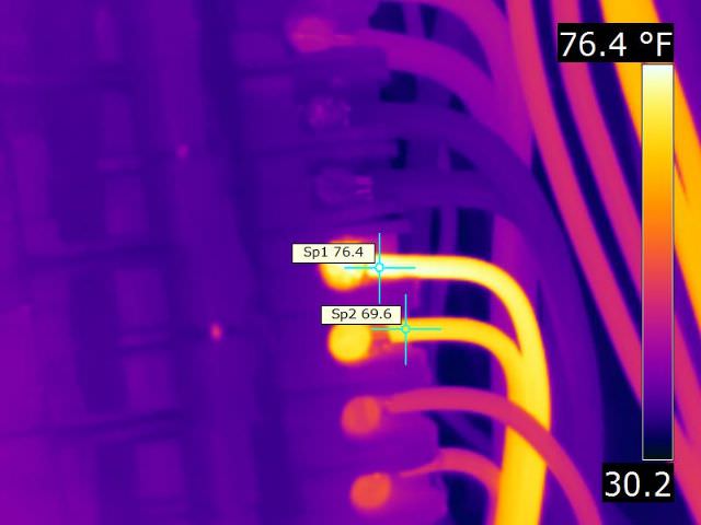

Old Sailor Posted February 24, 2015 Report Share Posted February 24, 2015 I scan every electrical panel in a loaded condition with what is available in the home during the course of a standard home inspection. Tell me if there is anything in this image that is reportable as in need of repair. The breaker is a double pole 240 volt breaker for the cook stove with the cook stove operating Click to Enlarge 30.2 KB Link to comment Share on other sites More sharing options...

ghentjr Posted February 24, 2015 Report Share Posted February 24, 2015 Does not look like any problem. The differential between both lines is minimal. If the cook stove had resistance type burners they are different sizes. If a glass top, well, they are not very well calibrated. I would not report a problem based on your pictures. Is the cook stove on the same circuit as the oven? P.S. I don't even know how to turn on an IR camera. In my day we just held our hand over the burners. Link to comment Share on other sites More sharing options...

palmettoinspect Posted February 24, 2015 Report Share Posted February 24, 2015 The temperatures are ok. I wouldn't think anything of it from the picture, but now you got me wondering. What about the wires that show some heat at the right side of the picture maybe? Link to comment Share on other sites More sharing options...
kurt Posted February 24, 2015 Report Share Posted February 24, 2015 I'm sensing the setup, so cut to the point. What do you think is wrong? If nothing is wrong, where does it say 7degF delta is OK? Link to comment Share on other sites More sharing options...

Tom Raymond Posted February 25, 2015 Report Share Posted February 25, 2015 You placed your point marker directly on the problem. Makes the image hard to read. Loose connection. Fixing it will be far less effort than reporting it. Link to comment Share on other sites More sharing options...
mjr6550 Posted February 25, 2015 Report Share Posted February 25, 2015 Assuming all the range elements are on high and operating at 240 volts, then wouldn't a little difference in resistance at the screw terminals (or somewhere else in the circuit) account for that delta T? As to whether the difference is a problem, it does not seem like much to me. Then again, I generally only get concerned when the conductors feel quite warm. Link to comment Share on other sites More sharing options...
Old Sailor Posted February 25, 2015 Author Report Share Posted February 25, 2015 I'm sensing the setup, so cut to the point. What do you think is wrong? If nothing is wrong, where does it say 7degF delta is OK? Ok kurt the thunder is at half time so here goes. Kitchen breakers are my bread and butter for Home inspection IR. You won't find this in any IR book or IR class room. Cook stoves are one of the most used appliance in a home. Thus the terminals become loose, a cook stove breaker should have equal amp draw on both legs thus the temp should be the same on both legs. Unless there is a convection fan in the oven that operates on 120 volts some operate on 240 volts just like the elements and burners. I use a 3 to 4 degrees differential between the legs to determine if the terminals are loose. When I first started documenting this I would actually check the terminals to see if they were loose and I was spot on. About 1 out of 5 panels that have a electric cook stove have loose terminals Link to comment Share on other sites More sharing options...

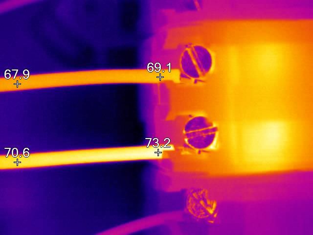

David Meiland Posted February 25, 2015 Report Share Posted February 25, 2015 Got me curious here. I opened the panel in my shop, tightened both of the terminals on the 30A breaker feeding the electric heater, ran it for 10 minutes, and took this image. Click to Enlarge 27.96 KB Link to comment Share on other sites More sharing options...

Old Sailor Posted February 25, 2015 Author Report Share Posted February 25, 2015 Got me curious here. I opened the panel in my shop, tightened both of the terminals on the 30A breaker feeding the electric heater, ran it for 10 minutes, and took this image. Click to Enlarge 27.96 KB Did the electrical heater have a 120 volt motor. Did you measure the amp draw on each leg you must compare apples to apples 4 degrees F between the legs is not bad BTW nice image what is your camera Link to comment Share on other sites More sharing options...
kurt Posted February 25, 2015 Report Share Posted February 25, 2015 I'm still trying to decide if this is a big deal. Meiland's got a 4degF difference in a "perfect" setup. I've done similar experiments resulting in temp differences of 3-6 degrees with everything tight. Are you proposing this is a necessary inspector task, or are we gloating in a "gotcha" kind of way? IR is a good thing to have, maybe even necessary nowadays if for no other reason than the competition has it. I use mine for radiant heating analysis more than anything else. Link to comment Share on other sites More sharing options...
