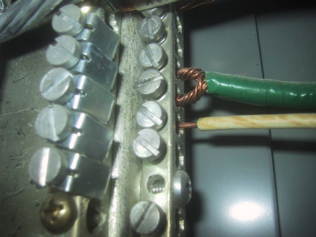

Jim Katen Posted February 28, 2015 Report Posted February 28, 2015 A timely find from this week. I'm pretty sure that this wire would have fit into one lug without too much trouble. Maybe the installer was a frustrated hairdresser. Click to Enlarge 39.53 KB
Speedy Petey Posted February 28, 2015 Report Posted February 28, 2015 Marc said: Speedy Petey said: It's definitely not allowed, and personally I don't care why. Code is code. Thing is, that will fit in one hole! I am amazed at how many times I see this when it is completely unnecessary. That looks to me like #2SER, which makes the EGC #4. Pretty much every modern ground and neutral bar WILL accept up to #4. #4 aluminum stranded? Marc 2-2-2-4 SER? Yeah, standard issue in my area.https://www.google.com/search?q=2-2-2-4 ... 8&oe=utf-8
